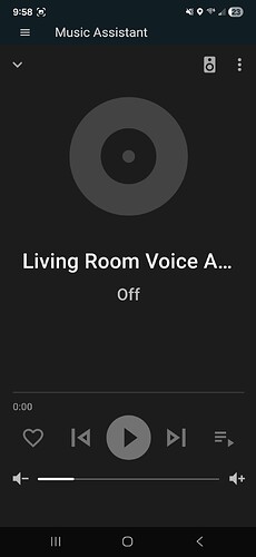

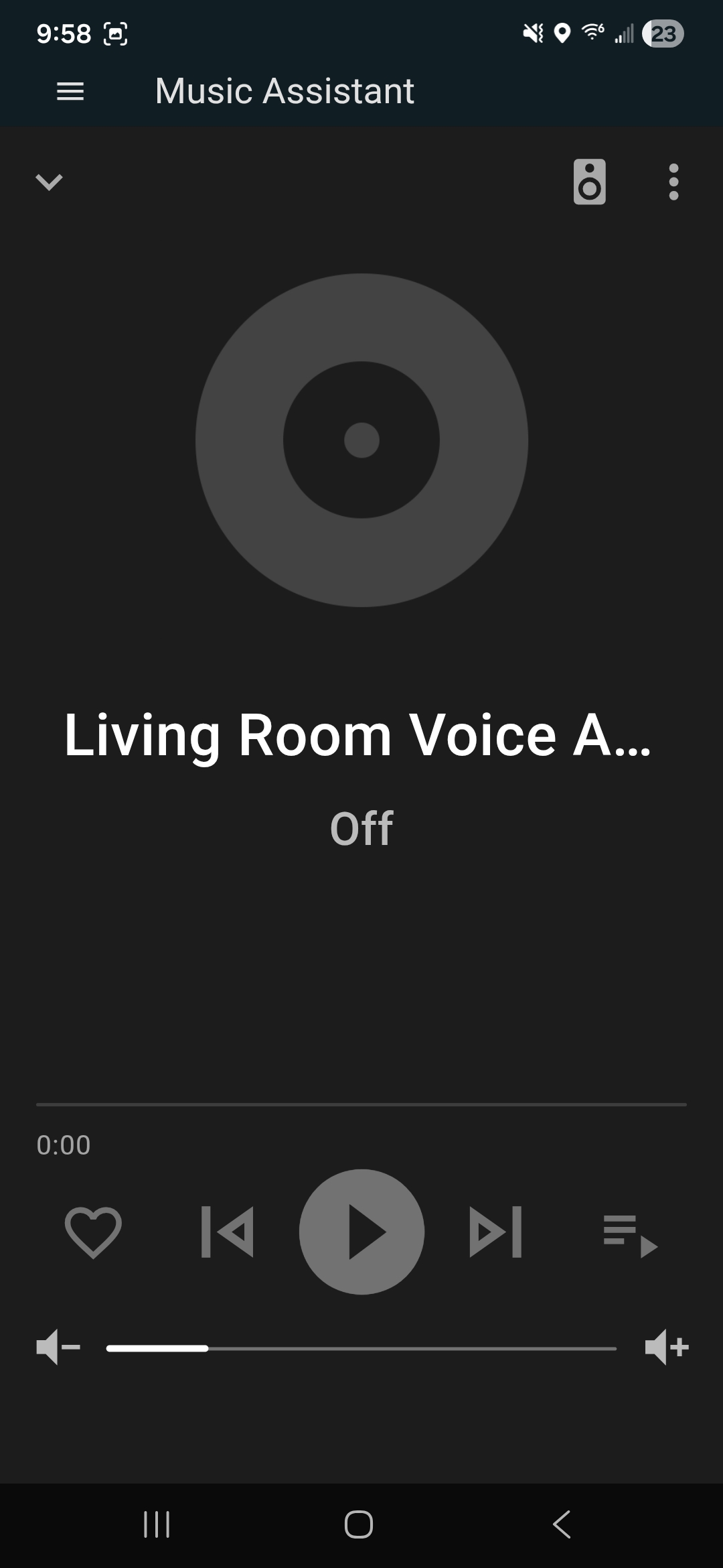

If the device is connected to speakers you tell music assistant to play to the device from your phone. And it plays… It’s casting direct from MA to the device and your phone is just controlling the action.
This is the HA companion app running Music Assistant targeting the Music Assistant player (ma sets up special entities) for my living room wired to one of my Denon receiver inputs through the 3.5.
You assign media, hit play. That’s it. (or in my case I ask the LLM to play Yacht Rock in the living room)
