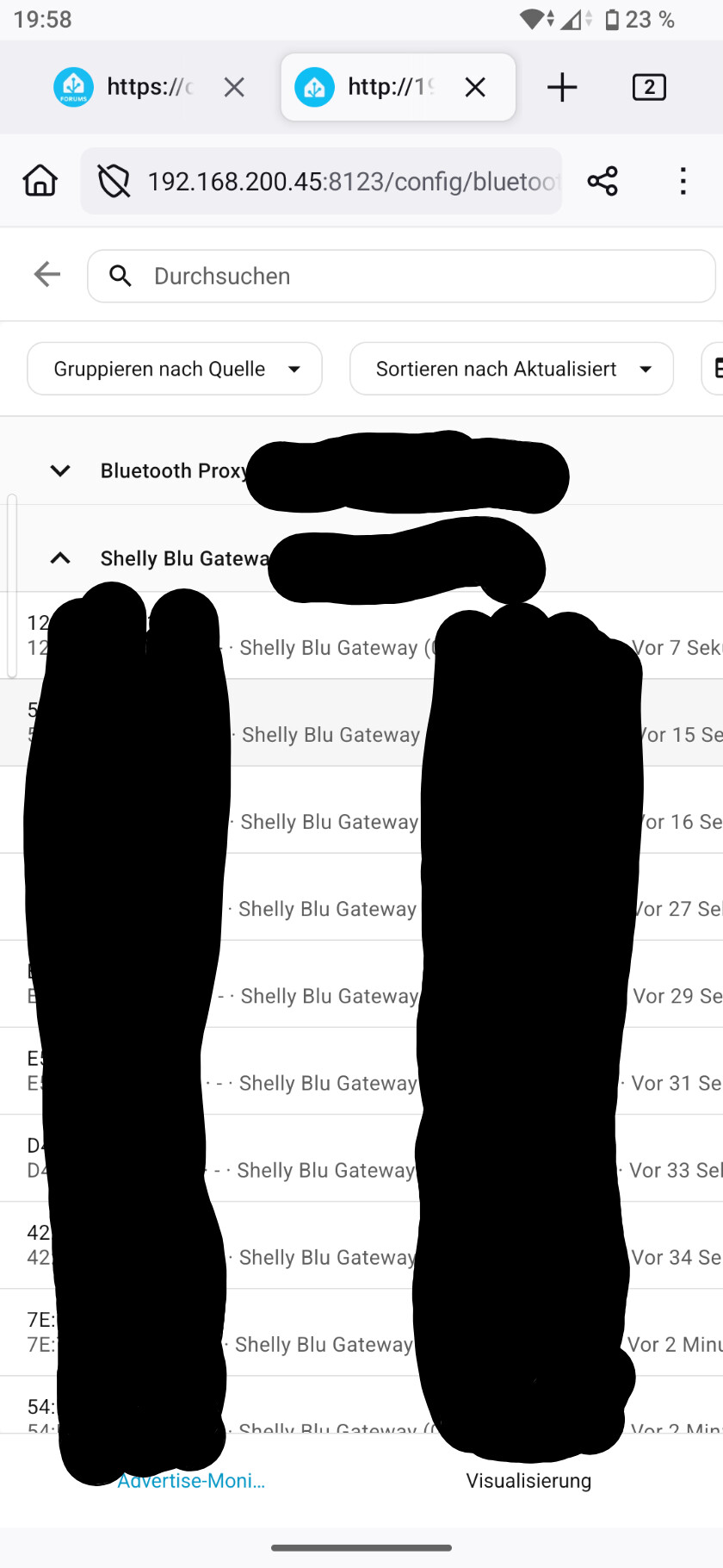

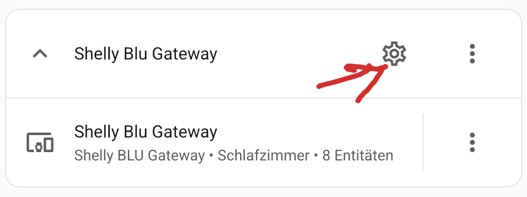

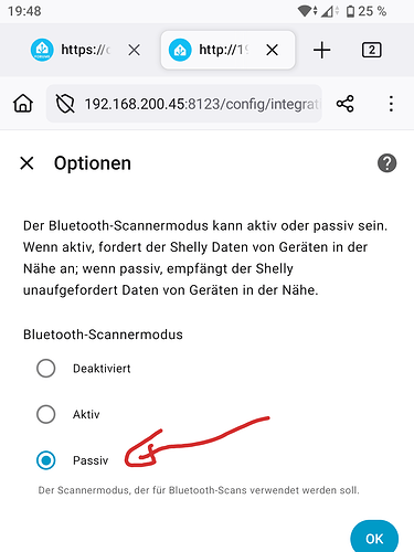

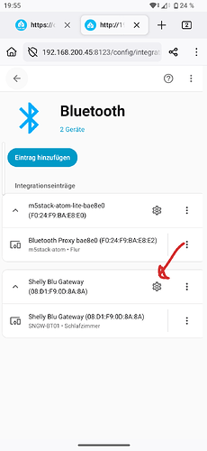

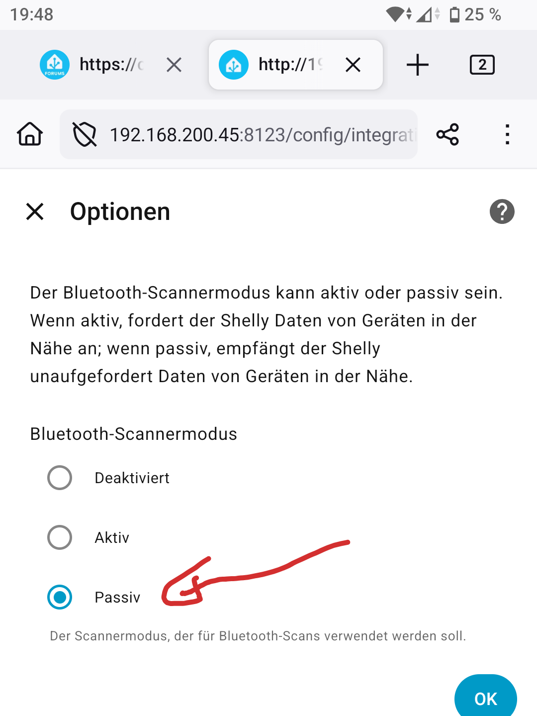

I only have a few Shellys acting as BT Proxies and it’s been a long time since I set them up, but if I remember correctly there were like 3 different settings that had to be adjusted between on the Shelly itself (so in their app) and in HA for the device to get it to fully operate at a BT Proxy. It kind of sounds like you don’t have the one in HA set; under the settings for the device you have to enable the BT scanner option.
