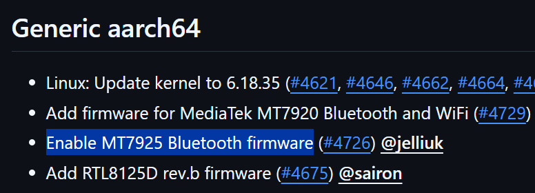

@Nipal spotted this in the OS18.0 release notes & somehow managed to remember about your post. Looks like it's supported now!
