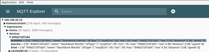

Using MQTT explorer you can see which devices arrive http://mqtt-explorer.com/
Therefrom you can check e.g. the “name” information to identify the devices.
2022-02-19_20-55-36
