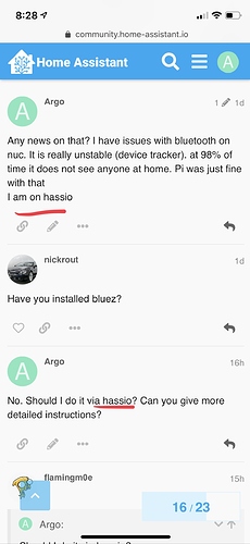

You are very informative. I am on hassio and I have no idea how to install bluz.
Sorry, but I have no idea how to work with host OS. How can I install that on nuc?
This is the first time you told us that, try and be more informative in future if you want answers.
Are you on hassos or another base operating system?

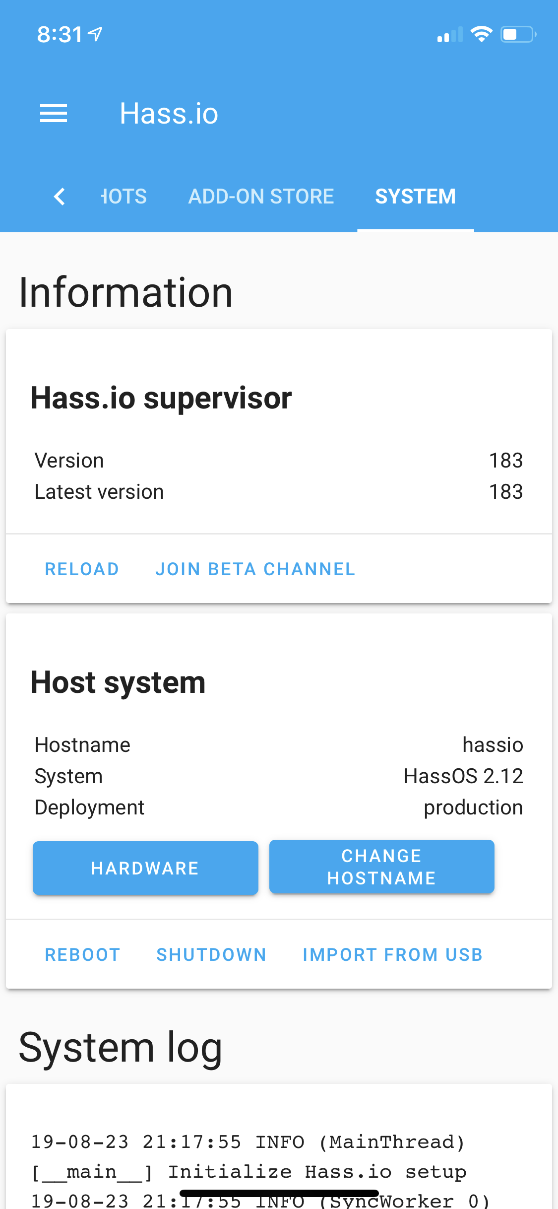

Ok, I should be on hass os, because I have downloaded hassio from the top of this page a week ago (there is version for nuc).
Now sure I am on hass os
Yes sorry I did miss the first mention. Anyway there is more than one way of installing hassio, one of them is hassos, the other way is on top of another OS like ubuntu or debian.
With hassos for x86/amd64 I have no idea how to install bluez, assuming it isn’t there by default.
