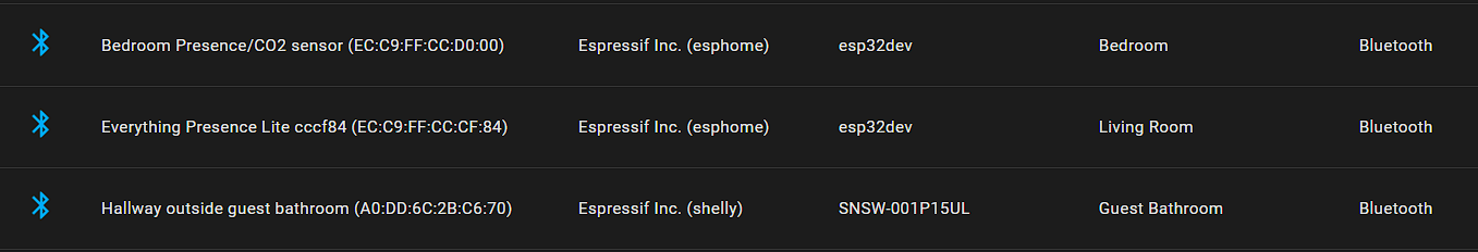

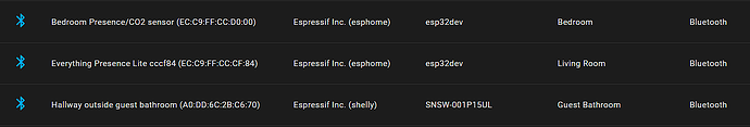

My experience is that if the HA instance doesn’t see a local Bluetooth adapter, you can’t use Bluetooth proxies either. My HA is installed on an openwrt that isn’t detecting the built-in Bluetooth.
I got a USB-BT500 from Asus. I don’t know why I settled on rtl8761bu but here we are. I have to say I was skeptical about just installing the firmware. But it worked. Or it’s in some weird netherworld of working. hciconfig detects the device. I can scan from the command line and it’s as though it was functional. But when I go into /dev there is no HCIx device. Anyway, HA saw it enough to detect an active Bluetooth adapter and suggests a -v command for making it available to my docker container. I did that and it made no difference. At least the Bluetooth half-detection is sufficient to survive a reboot :slight_smile: My theory is it’s colliding with the OS’ detection of an onboard Bluetooth device and not managing to use it.
I’m a little bummed it isn’t working directly but it was like hitting one of the mushrooms in Super Mario - I leveled up and all of a sudden HA started detecting Bluetooth proxies. It saw my Shelly device first, then I setup my Everything Presence sensors to proxy and it detected each of those as they came back online with that option set in their config. Eventually the emmc in the little rockchip device running HA will fail and I’ll move the Bluetooth to its successor - it’ll eventually get used directly instead of as a magic talisman that unlocked proxy detection.
I had expected to see the Shelly BT proxy show up a week ago when I re-did that switch, but it wasn’t usable in HA until the local BT adapter loaded firmware.
