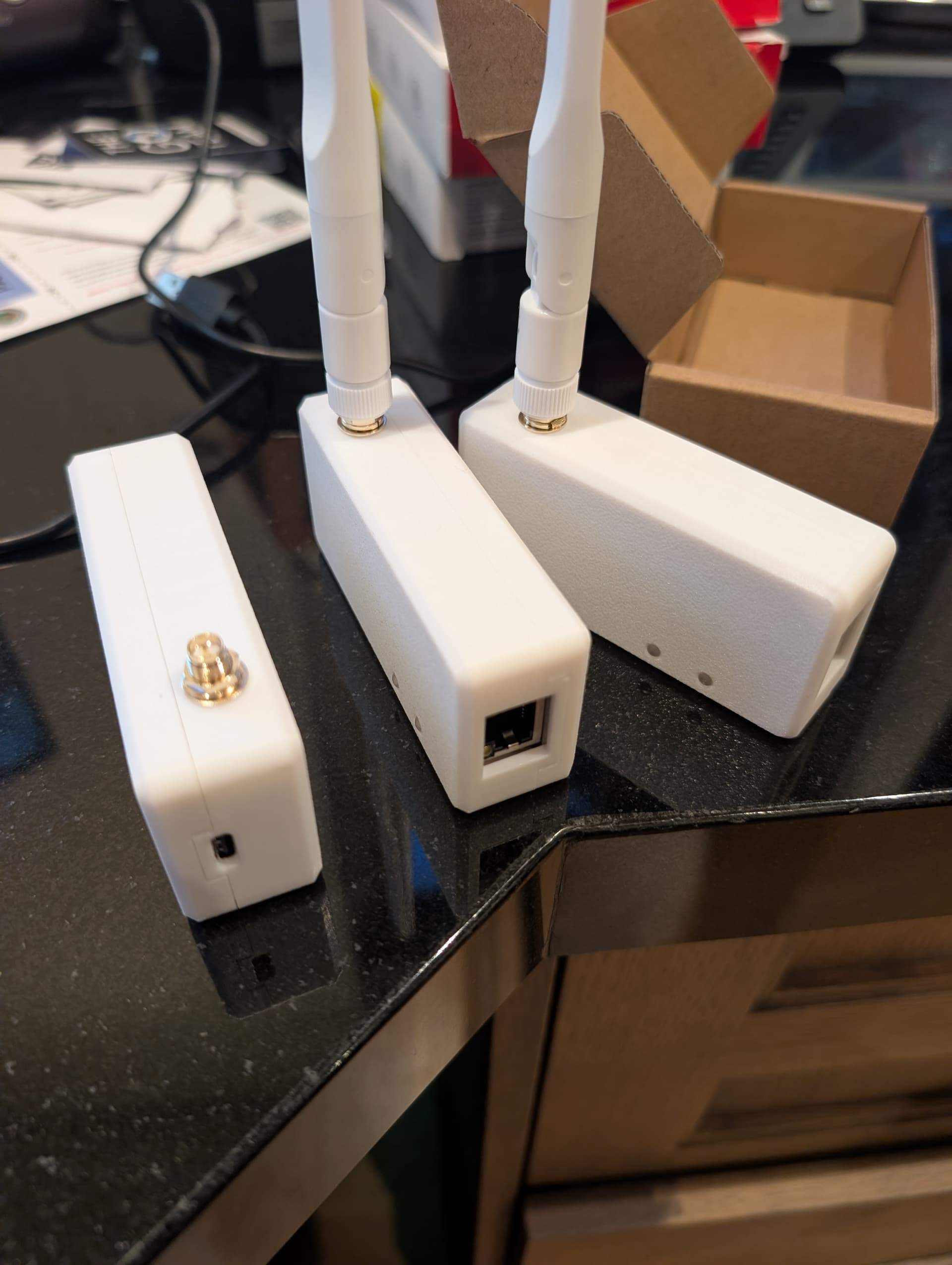

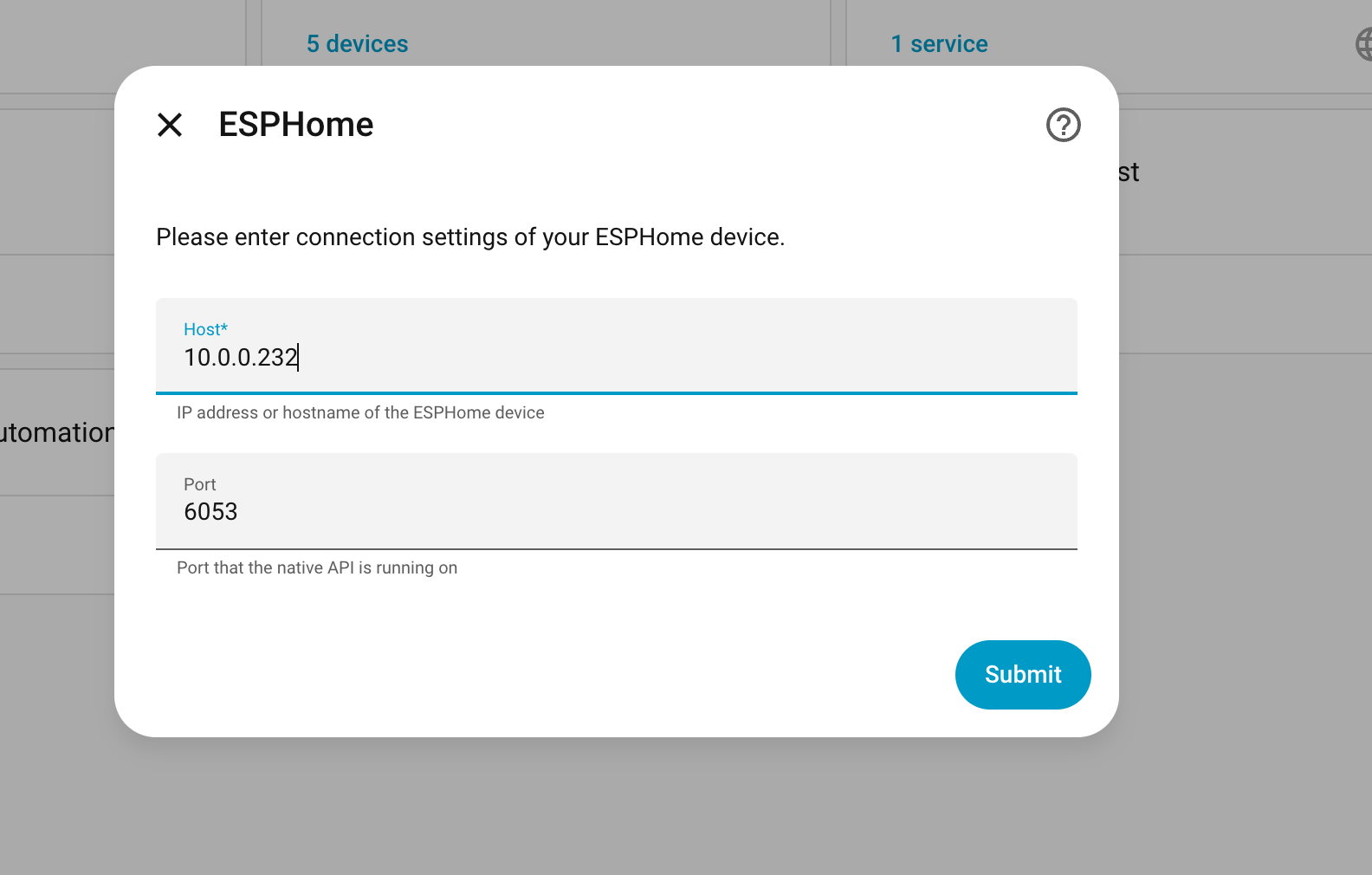

Hi. I just got a few of these to implement BT proxy coverage in our house. When I plug them into the home network, they do get an IP address, but they don’t seem to be detected by home assistant, even on the same network, and I generally put these types of devices on a VLAN that is restricted. Do they have to be on the same VLAN as HA? I do have MDNS forwarding active so ESPHOME works fine and I have other esphome devices in the house that I can config and update etc…
If I need to load the config through the USB port on esphome, is there a config file already made for bp2 that I can load? I try connecting to the IP address via the browser, but the usual esphome menu doesn’t come up.
Usually, they will automatically enable the relevant features and be detected by HA. If this does not happen, you can try adding them directly using their IP address; this can be done by selecting the Esphome component in HA and entering the IP address.

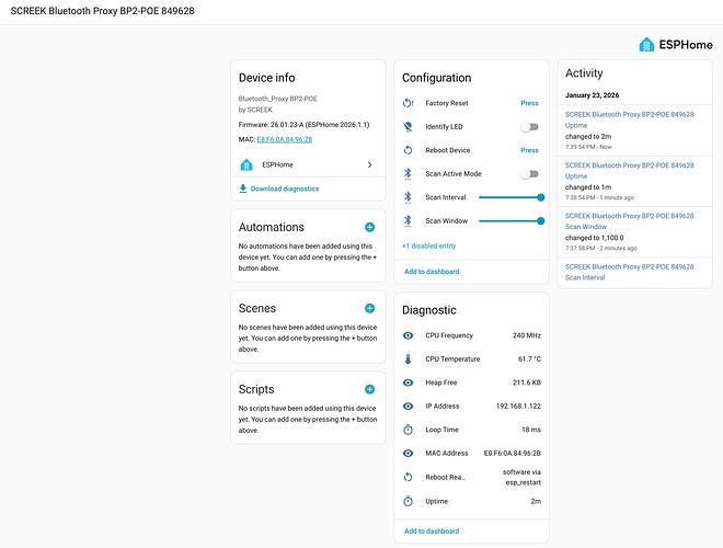

Due to memory constraints, the web interface for the bp series sensors cannot be accessed directly (as the web service has not been enabled).
i make a small video demo the two way add bp2, maybe it helps.
They don’t show up automatically, and when I follow the 2nd approach in the video, I get “Unable to resolve the address of the ESPHome device. If this issue continues, consider setting a static IP address.”
I am running HA 2026.4.2, and HAOS can ping the device, so I don’t think there is a connectivity problem. Note this VLAN has no access to the Internet.
Why did you turn the web UI off in the BP2? Normally a BT proxy is a minimal memory load for a ESP32 controller. Is the BP2 trying to do something beyond being a BT Proxy? What is the config file in use?
I can try and flashing it manually from the esphome unless you have another idea as to why its acting that way. Also, what does the button on the bottom of the case do?

None of the BPs come with a web interface, as they operate in connection mode (which is the official configuration). This consumes a significant amount of memory, and they also scan for nearby BLE devices and send aggregated data to HA.

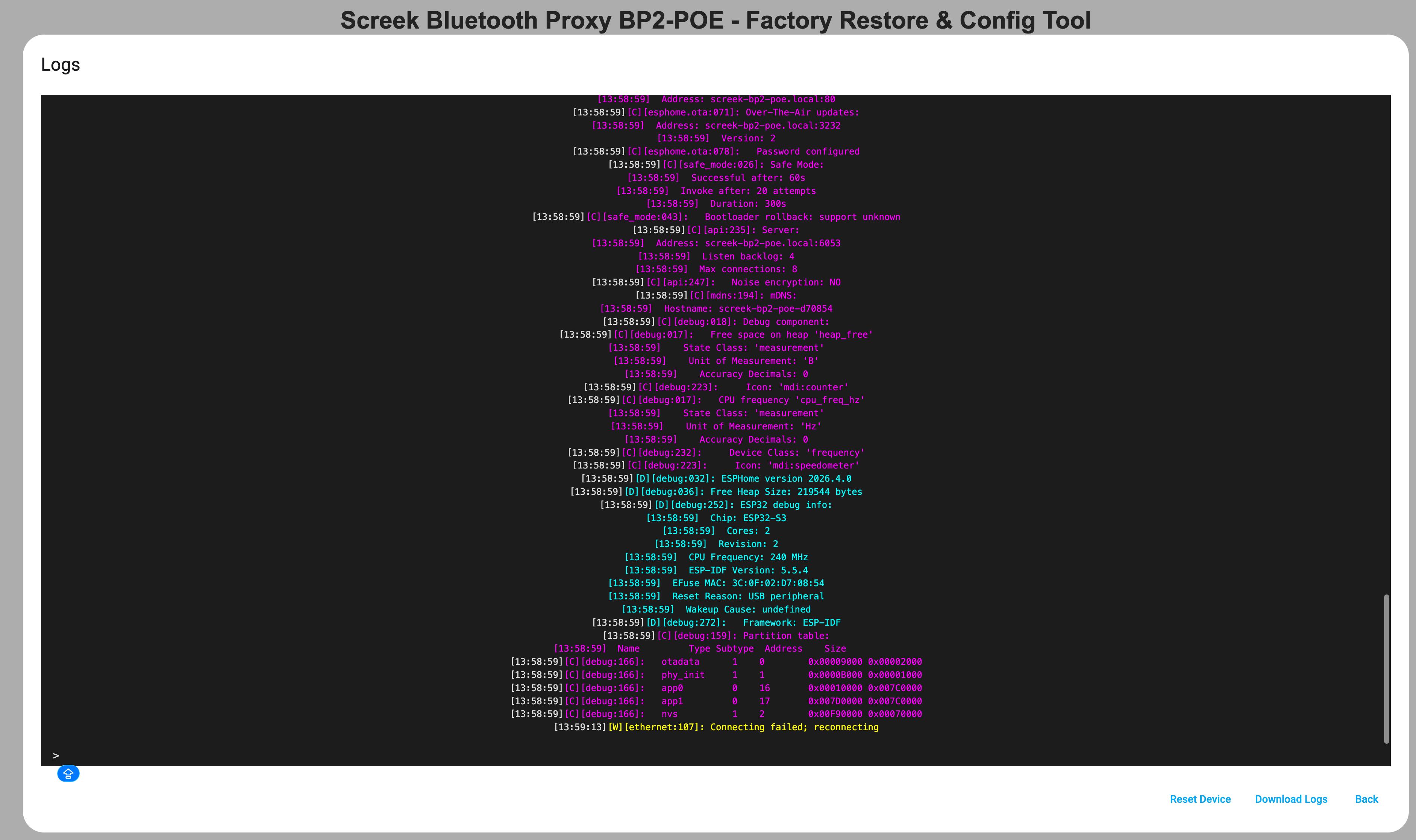

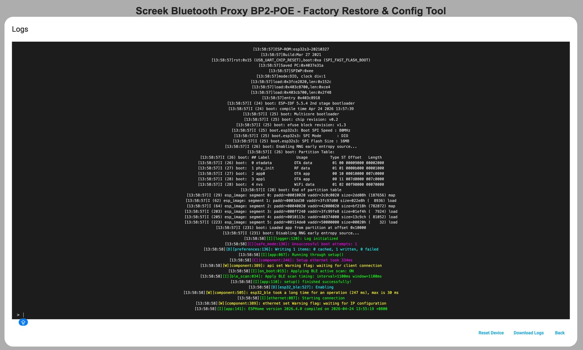

Using your factory reset tool didn’t work either. Very odd.
When I used esphome to build a .bin file using your .yaml config on the github site, and then installed it on the device, I get this repeating sequence in the logs:

Could you take a photo so we can confirm that this is a BP2 gateway?
We have manufactured over 200 BP2 units, and this is the first time we have encountered such a strange issue.
As for the compilation, it appears that the correct flash content cannot be loaded.
We recommend using the recovery tool to restore the device to its factory firmware, and then using the recovery tool to read the logs; this will help you understand what is happening with the device.
Given that this information is visible during a normal boot process, it now appears that the device has either failed to obtain a valid IP address or has not booted correctly into operational mode. To troubleshoot this issue, it is necessary to retrieve the device’s runtime logs; the recovery tool can read this information via the serial port.

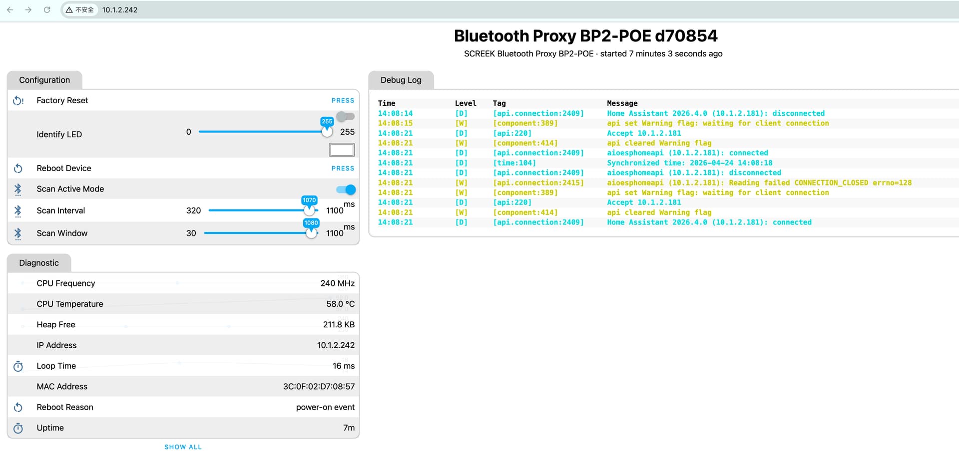

As you mentioned that a web server might be useful, we have compiled a version that includes a web server
https://tool.screek.io/factory_tool/bp2_poe/with_web_server
We are not entirely sure how to view open ports directly. We have manufactured tens of thousands of Esphome sensors; if necessary, you can use Esphome commands to view the logs of remote devices directly, which could be considered a way of opening the black box.
Interestingly, the web server doesn’t seem to be using up much memory :slight_smile:

I gave it a go, and it looks as though Nmap can scan open ports.
~ ➤ nmap -p 6053 10.1.2.242
Starting Nmap 7.98 ( https://nmap.org ) at 2026-04-24 14:18 +0800
Nmap scan report for 10.1.2.242
Host is up (0.0074s latency).
PORT     STATE SERVICE
6053/tcp open  x11
Nmap done: 1 IP address (1 host up) scanned in 2.66 seconds
These are real bp2’s. I really like the device form factor and price - it’s a great value.
And on the one that I haven’t attempted to flash, port 6053 is active and listening, I confused that with the address of one of the others - my fault. It still doesn’t connect with esphome however, I get the “Unable to connect to the ESPHome device. Make sure the device’s YAML configuration includes an api section.” errors, which is why I asked about the purpose of that section. Have you tested it with the current version of HA?
I flashed the new version with the web server, but this version is not getting an IP address from my router. It is not showing any DHCP requests from the device since I flashed it with the web server version. Should I take one apart and see if it’s a different rev board?
Thanks for working this with me.
Judging from the picture, this is a similar hardware, but it may not be the same motherboard, so it may not be suitable for bp2 firmware. You may need to readjust it.
Oh my goodness, I got this from seed studio in a thread about the Bp2. This must be a different device! Complete apologies to you! Please disregard my posts - this is not your issue!
Yes, the different architecture means that this code won’t work in the same way; you should look for Seeed’s firmware.
