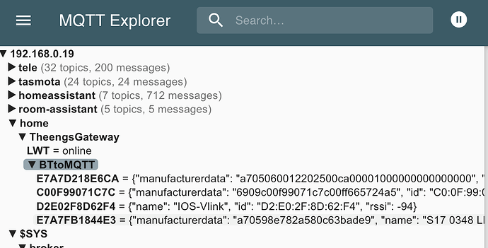

on mqtt side in HA side i see this:
Message 203 received on home/TheengsGateway/BTtoMQTT/C00F99071C7C at 11:50 AM:
Message 201 received on home/TheengsGateway/BTtoMQTT/E7A7FB1844E3 at 11:50 AM:
so, MQTT is receiving, but what now? I see no devices or other stuff. The above i just read with the help of the tips i found in the mqtt config web page…

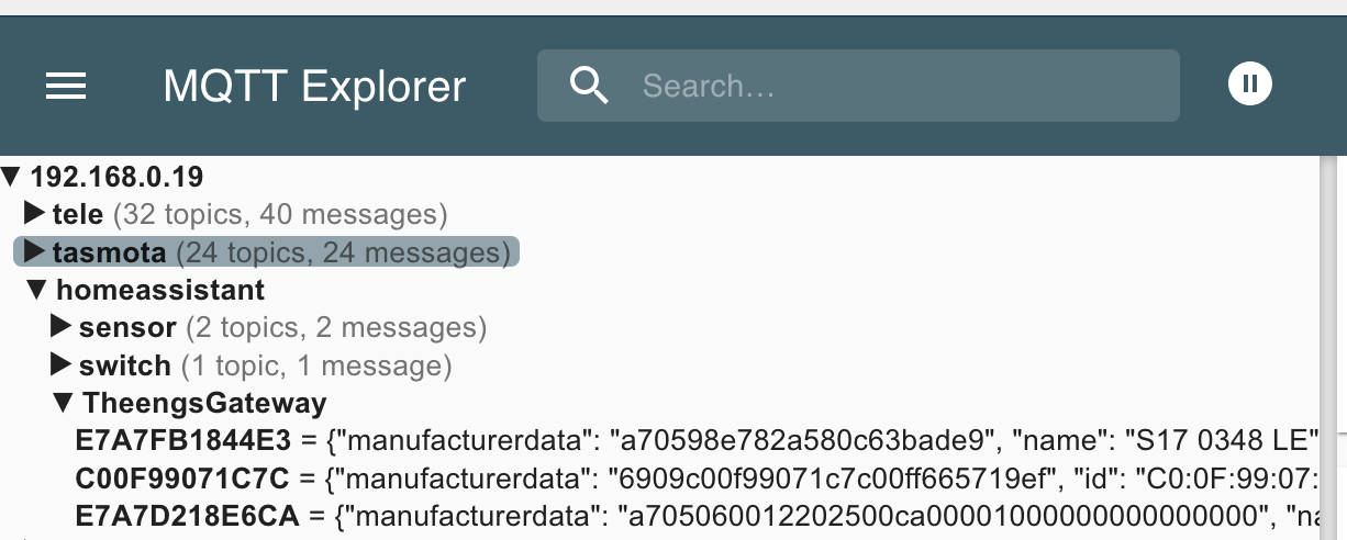

Your above picture and your startup command show that you have changed the publish topic for Theengs Gateway to homassistant, which should only really include the discovery messages, but not the actual published messages, which per default go into home.
So in your picture the actual published messages in homassistant are likely not being recognised by HA. Also the -st --subscribe_topic is set to homassistant, which will also not work if you are using OpenMQTTGateway ESP32 proxies.

I was already expecting that, as also in your previous screenshot from MQTT Explorer none of the devices being picked up by Theengs Gateway are recognised and decodable devices. So no discovery messages can be created for auto-discovery, as Gateway does not know what kind of devices with which properties they are.
All auto-discoverable compatible BLE devices for Theengs Gateway are listed at
Are you expecting to get certain properties from the devices listed in your screenshot from their advertising data? If so we can try to create a decoder for them together so that they can be added to the compatible devices listing.
