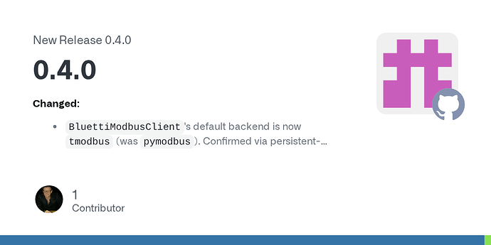

A finding worth passing on
While testing persistent connections we switched our client library’s default backend
from pymodbus to tmodbus. Reason: pymodbus reports a truncated or corrupted
reply as a generic timeout, while tmodbus correctly surfaces it as
ModbusProtocolError. We lost a fair amount of time debugging “timeouts” that were
actually malformed frames. Worth knowing if you’re chasing a flaky Modbus device of
any brand.

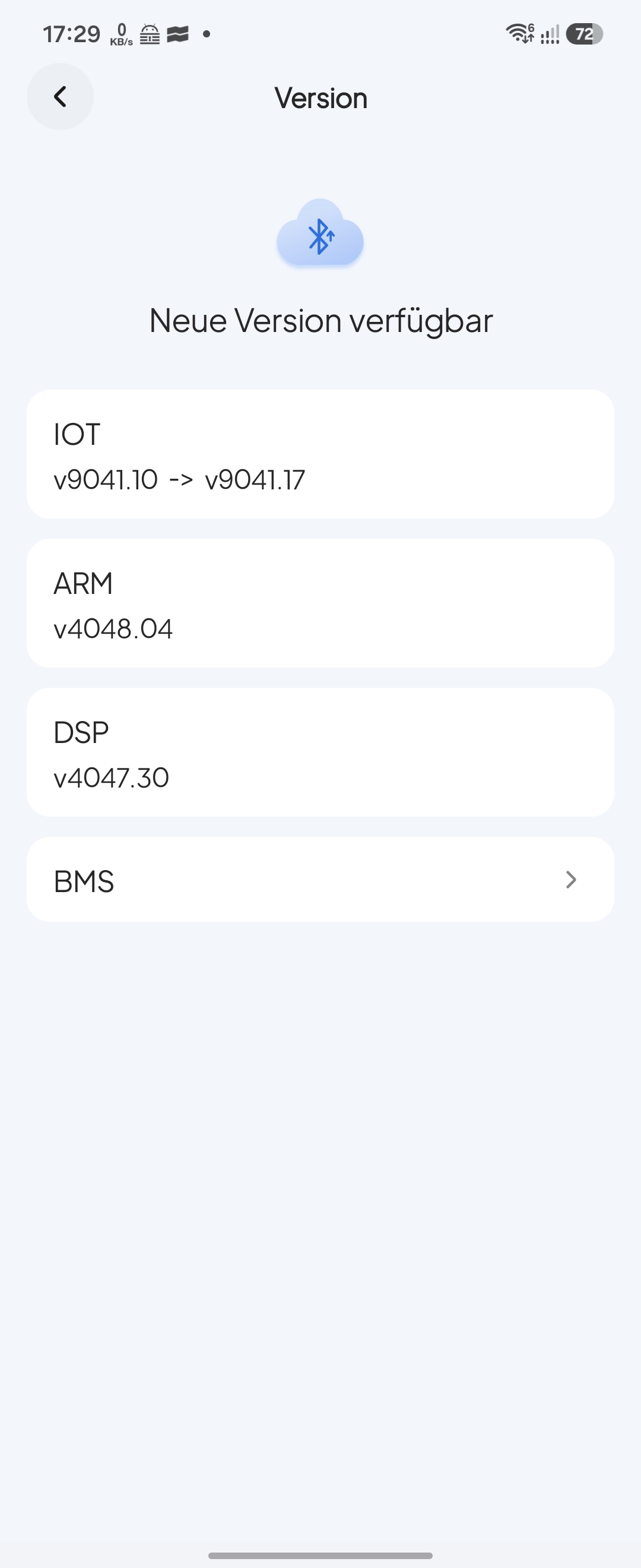

I cannot reach my AC500 via its IP. I can ping this IP, but there seems to be no webserver running I could connect to.
Is there some trick you didn’t add in the how-to?
Maybe this will help you, and maybe this one, too.
You need a specific version of the firmware.
Thanks, you are right, the *.17 version is offered yet I do not have any option to do the update itself. Maybe I need to contact the Bluetti support.
Try to clean cache apps, remove app, etc…
It should be popup an install :face_with_diagonal_mouth:
