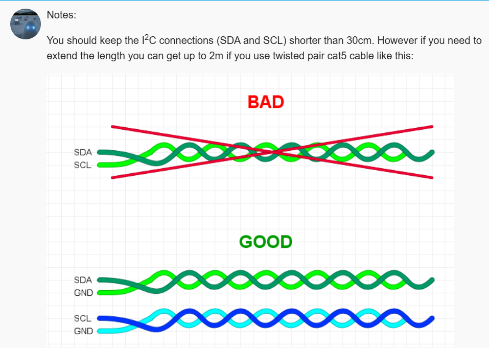

Since I doubt your software really cares about indoor/outdoor, your wiring would be still my suspect. One flimsy connection or cold solder joint can behave unexpected when temperature changes. Long I2C wiring is most common failure. Hardware squeezed in some enclosure with wire spaghetti is very common failure… Just wild guesses can be done here…

I connected to the serial port via cable and during the ESP boot i get a “BME680 Communication failed” warning. I also checked and the I2C aren’t twisted or anything, the distance they cover might be over 30cm but, again, it’s the same length they had when the sensor was working correctly before i mounted it outside. I’ve also left them loose without cable ties.
