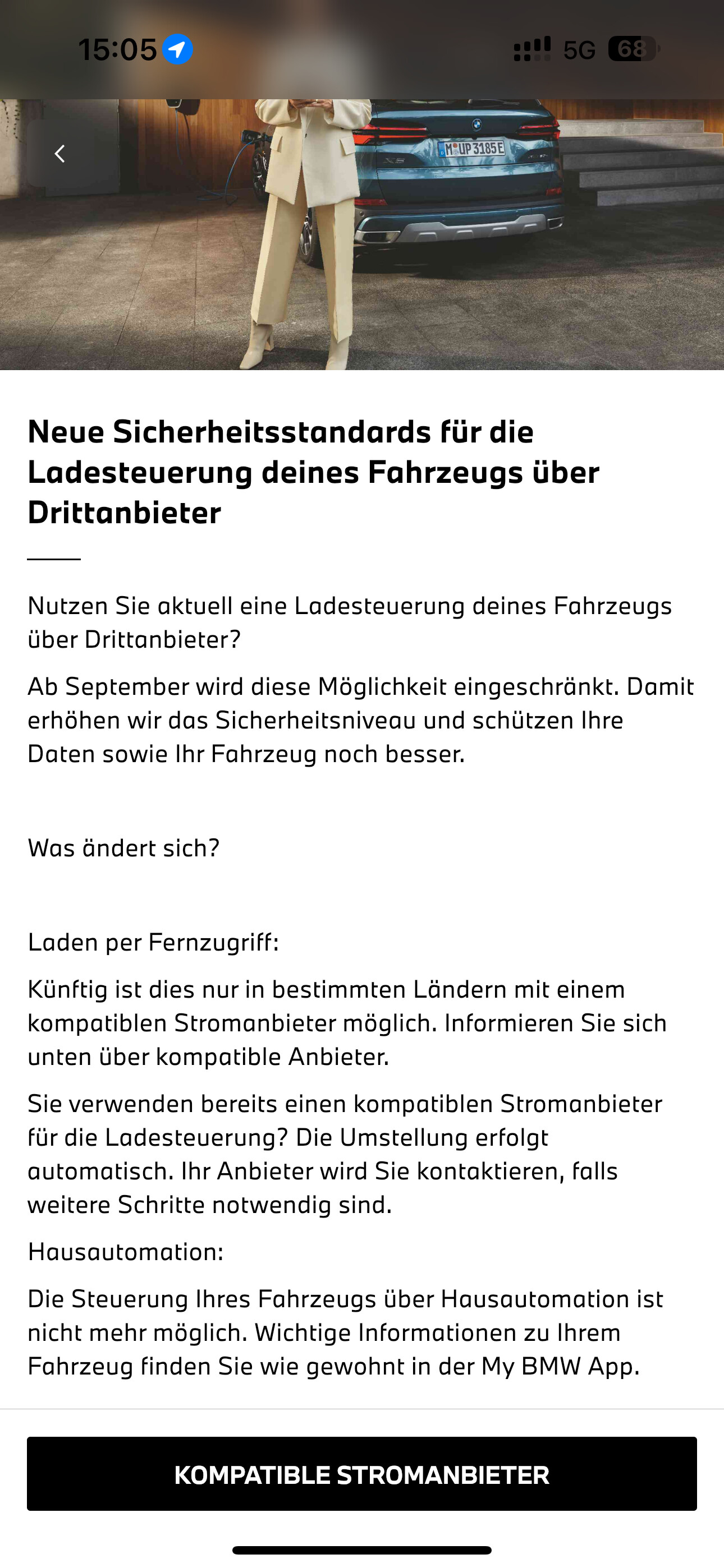

I just received a message from the BMW app, that there will be no support for thirdparty providers like Home Assistant (see printscreen attached, unfortunately only in german). Are there already some ideas oder solutions or will this be definitly the end for the BMW integration?

Well officially the current installation is also not supported by BMW. So as long as the app will work on your mobile phone, @gerard33 and his team of magicians will figure out the API calls needed to retrieve data from BMW into homeassistant.
If I understood correctly, the integration and API connection with BMW will continue to work. However, features that are necessary for charging the vehicle will no longer be available to third-party apps. I assume this includes things like setting a charging target, etc.
It will still be possible to view the vehicle’s location and check the status of doors, windows, and similar features.
At least, that’s how I understood it.

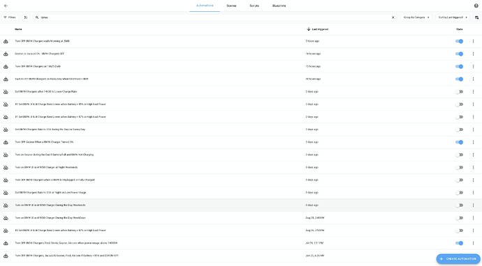

This is really sad from BMW side, I had to disable a lot of rules this morning due to integration stopped. I cannot see possible security issues for reading data from BMW via API on a logged-in account since you have to authenticate to BMW with username/pass/captcha token. Hope they find a workaround. I have a lot of rules configured to check lowest BMW SOC of the 2 vehicles I drive, then switch on that specific smart breaker to charge lowest battery first and also adjust Charging Amps / Charge Target based on battery state / pv panels charging state to solar system and home load power etc. I cannot charge 2x EV’s at the same time due to limits in our country of 13kW on Single Phase. Now the charging and switch on/switch off will be manual again
which is a pain

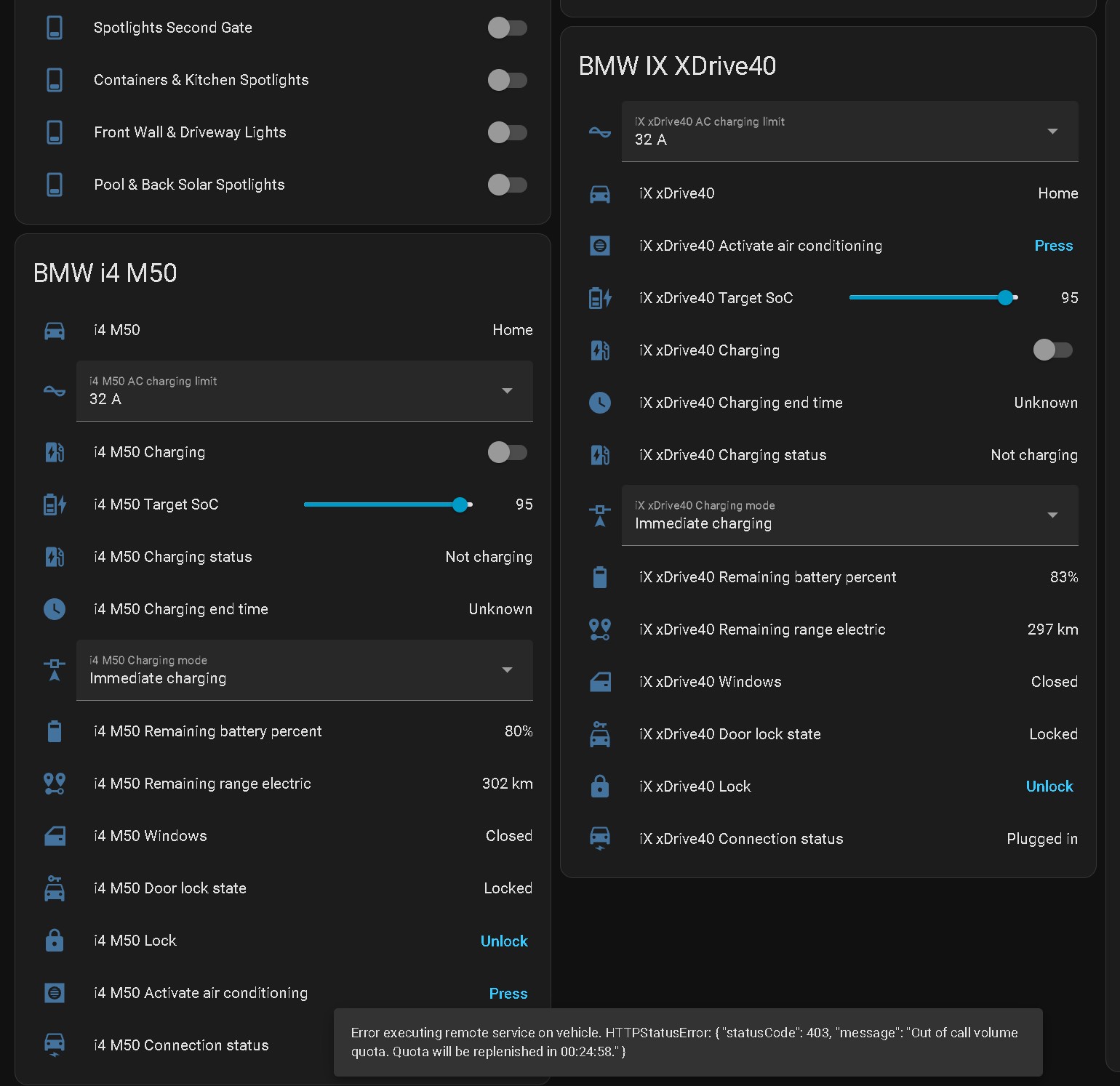

The BMW Integration authenticated this morning again and shows all statuses on the vehicles. API calls seems limited to a quota now. When I change a single field I receive message attached. Will check if 1 API call can be made every 30min as per message.

there’s an active issue on this here BMW integration should handle call quota error · Issue #151500 · home-assistant/core · GitHub

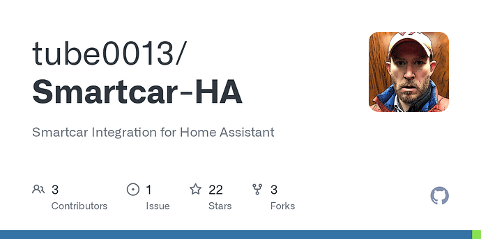

Wanted to chime in here and express that of course I am equally disappointed in the changes. However, while not a complete replacement, I found the smartcar add-on discussed in the Github issues for the BMW integration and decided to give it a whirl. So far, so good. I have no idea if I’ll run into the limit of free API calls per month but it’s got the basics. SOC, Charge limit, turn charging on/off, even has tire pressure, door locks, range and odometer for my i4. Wish it had climate as well but otherwise this will do for me for now at least.
I’ll try to report back if I run into issues but it worked pretty smoothly so far.
Also, they’re moving over to a webhooks based model in v3, so it looks like you may be able to get things like SOC without incurring any queries that might count against a free tier. With v3 comes what appears to be a new billing models, so everything is subject to change.
I’ve got a beta up with webhooks support if you want to try it.
