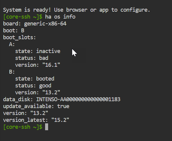

same for 15.2
Out of curiosity, how many people that had the issue with updates not working have now started getting the “duplicate OS” warning?
same here: Is a solution pending??
I still cant update. Guess i’m not the only one.
I still can’t update. I hoped the new core update would solve this.
