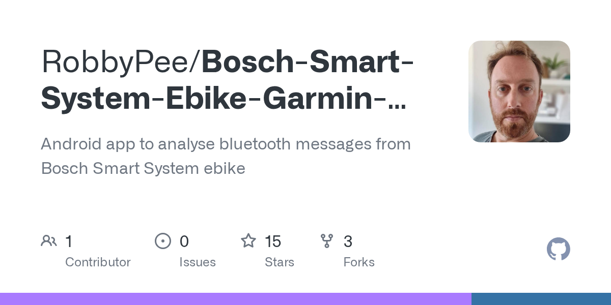

Hi All, i recently bought an ebike with the Bosch smart system. I was reading up on this thread and would also love to be able to readout battery percentage vlua bluetooth on an ESP. I recently fount this Github of someone who mad an android app and was able to decode bluetooth messages for battery percentage level!
I though this might come in handy for the people who managed to make a connection to their bike through ESP.
