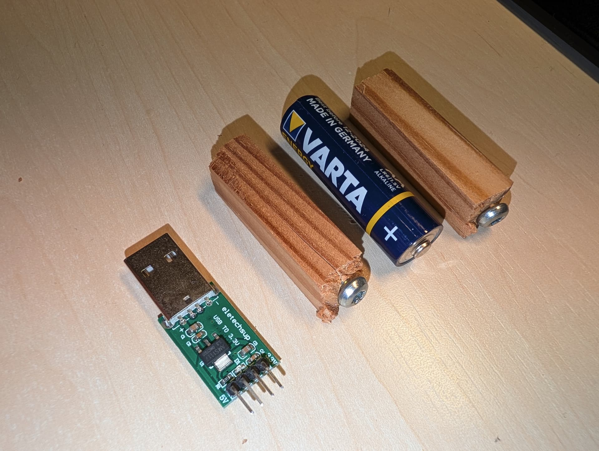

It can easily be done with a few parts.
The USB module is a buck converter that outputs 3.3V (= two batteries) or 5V (= 3 batteries).
The wood pieces are just for filling the gap in the battery compartment of your device, so it should have about the same diameter as a battery and the length should be a bit below the length of a battery. The screw can be used to fit the correct length.
The pictured screw head might be too big for some battery compartments, because the plus point is only the space of the top of the battery, but that is just a question about finding the right screw.
The only missing parts is an old USB charger (1A is usually more than enough) and some wire, and maybe some soldering (I crimp them in dupont connectors instead for the connection to the USB module and just wrap it tight around the screw).
