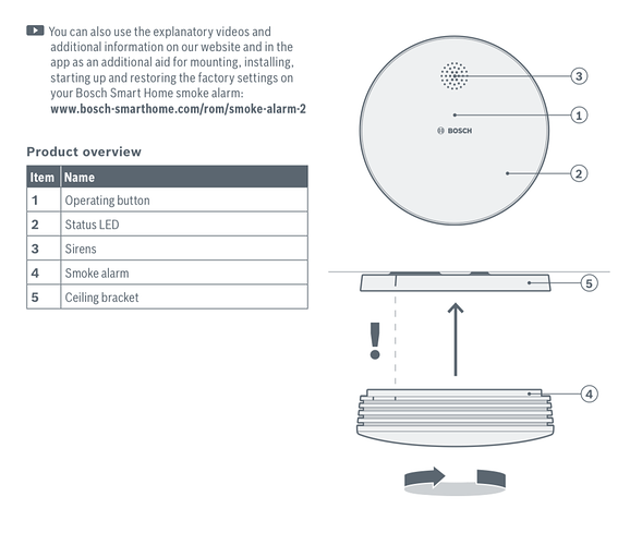

Really? Shouldn’t you just press the smoke detector (hardware, i.e. the device) itself? At least that’s what the Operating instructions say.
Never happened to me at least
Oups, maybe I have to read the user manual. Thought I read that the batteries have to be removed but it was a while ago and I probably only skimmed through it. That would be great if that’s true because some of mine are sitting 4 meter up making it annoying to get there.
From the manual:
After checking, initiate emergency measures. If there is no hazard, acknowledge the alarm on the detector which triggered it.
Unfortunately, you also have to touch the device to do this. But a broomstick could help. :sweat_smile:
