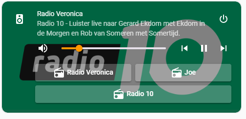

I wanted to use a media player to change stations, but keep using the display on the device to see channel and current song/artist.
This component is the mini media player. See GitHub - kalkih/mini-media-player: Minimalistic media card for Home Assistant Lovelace UI
You can start a direct streaming url, but this does not give you any details and the display shows unknown stream text. I wanted to use tunein without presetting station on the device, so this information is shown and also shown in HA.
Add the mini-media-player custom card in your UI. Example yaml:

What is the tune-in-id-station? Go to tune-in and go to your desired station. The s number is in the URL:
So for radio 10 the location is /v1/playback/station/s16793, for radio veronica the location is /v1/playback/station/s6717. Note: keep the ‘s’ in front of it.
Display now works on the Bose and home assistant changes the background and also shows details.
