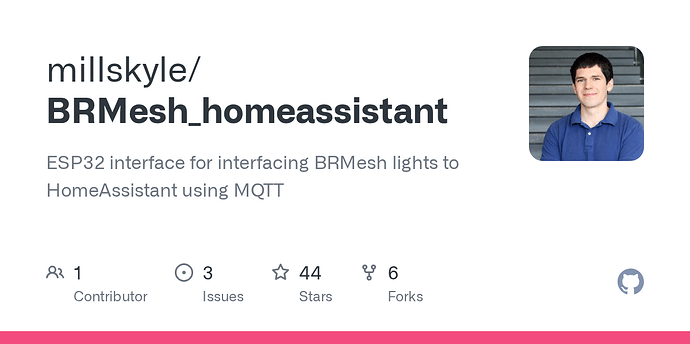

I am trying to control my BRMesh bulbs directly in home assistant using the following ESP32 solution

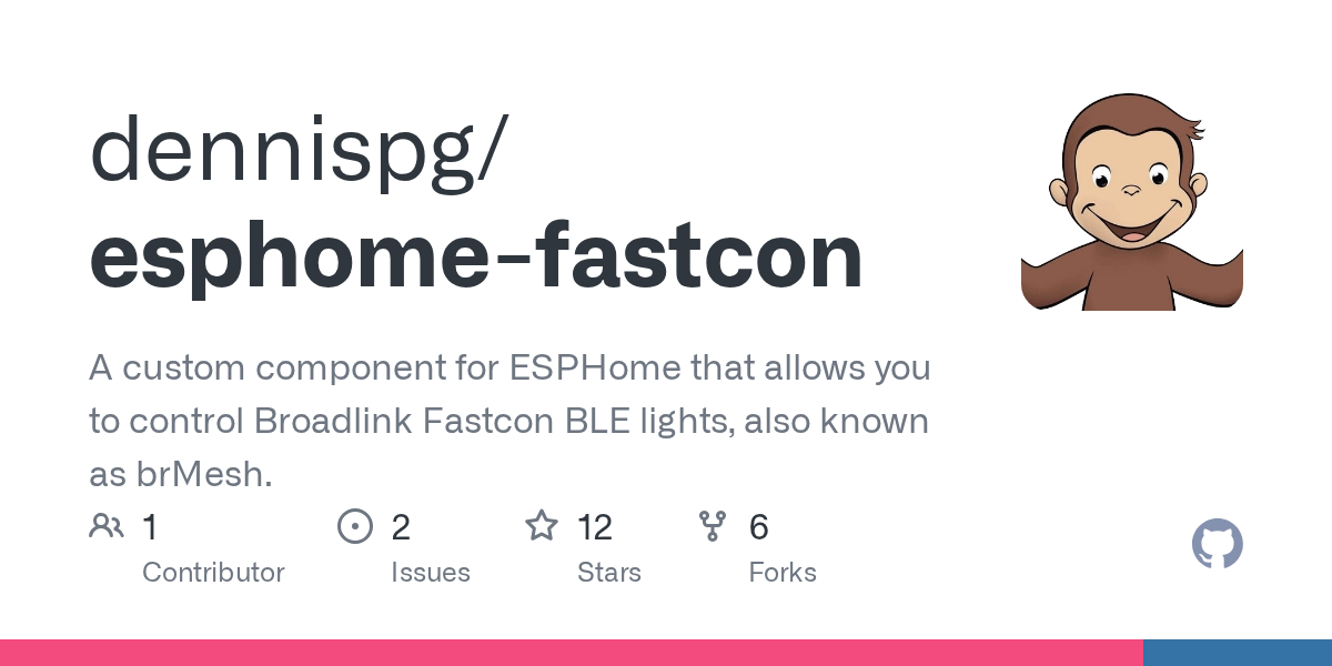

I’ve also been trying to get the MQTT solution to work. I’m now looking into a ESPHome solution though since I can’t get the MQTT app you listed to compile. I can help with ‘grep’ though. ‘grep’ is a Linux command. If you are using windows, try using ‘findstr’ as a direct replacement for ‘grep’.
