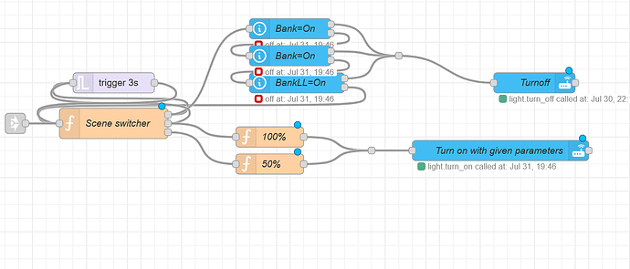

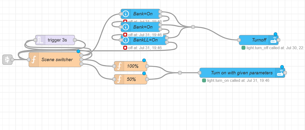

Before i used this this nifty peace of code in node red, which is very easy to expand with more conditions.
export [{"id":"3d958283059b7308","type":"api-call-service","z":"9d267bfa767e8a46","name":"Turn on with given parameters","server":"90c6e8da.709198","version":5,"debugenabled":false,"domain":"light","service":"turn_on","areaId":[],"deviceId":[],"entityId":["light.0_woonkamer_bank_lamp_leeshoek","light.0_woonkamer_bank_spot_links","light.0_woonkamer_bank_spot_rechts"],"data":"","dataType":"jsonata","mergeContext":"","mustacheAltTags":false,"outputProperties":[],"queue":"none","x":830,"y":240,"wires":[[]]},{"id":"a9bd982346aba1d9","type":"api-call-service","z":"9d267bfa767e8a46","name":"Turnoff","server":"90c6e8da.709198","version":5,"debugenabled":false,"domain":"light","service":"turn_off","areaId":[],"deviceId":[],"entityId":["light.0_woonkamer_bank_lamp_leeshoek","light.0_woonkamer_bank_spot_links","light.0_woonkamer_bank_spot_rechts"],"data":"","dataType":"jsonata","mergeContext":"","mustacheAltTags":false,"outputProperties":[],"queue":"none","x":880,"y":140,"wires":[[]]},{"id":"60b7c4dfa092fa24","type":"api-current-state","z":"9d267bfa767e8a46","name":"Bank=On","server":"90c6e8da.709198","version":3,"outputs":2,"halt_if":"on","halt_if_type":"str","halt_if_compare":"is","entity_id":"light.0_woonkamer_bank_spot_links","state_type":"str","blockInputOverrides":false,"outputProperties":[{"property":"payload","propertyType":"msg","value":"","valueType":"entityState"},{"property":"data","propertyType":"msg","value":"","valueType":"entity"}],"for":0,"forType":"num","forUnits":"minutes","override_topic":false,"state_location":"payload","override_payload":"msg","entity_location":"data","override_data":"msg","x":520,"y":60,"wires":[["13db3a385d4109ea"],["c60a3e73392efc58"]]},{"id":"3929e74b611f7362","type":"api-current-state","z":"9d267bfa767e8a46","name":"BankLL=On","server":"90c6e8da.709198","version":3,"outputs":2,"halt_if":"on","halt_if_type":"str","halt_if_compare":"is","entity_id":"light.0_woonkamer_bank_lamp_leeshoek","state_type":"str","blockInputOverrides":false,"outputProperties":[{"property":"payload","propertyType":"msg","value":"","valueType":"entityState"},{"property":"data","propertyType":"msg","value":"","valueType":"entity"}],"for":0,"forType":"num","forUnits":"minutes","override_topic":false,"state_location":"payload","override_payload":"msg","entity_location":"data","override_data":"msg","x":530,"y":140,"wires":[["13db3a385d4109ea"],["ac8a21acb67e1b01"]]},{"id":"ac8a21acb67e1b01","type":"function","z":"9d267bfa767e8a46","name":"Scene switcher","func":"//var count = context.get(\"counter\");\n\n// initialise the counter to 0 if it doesn't exist already\nvar counter = context.get('counter');\n\nvar NOC = node.outputCount\n//msg.noc = NOC;\n\nif (msg.payload == \"Reset\")\n{\n context.set('counter',0);\n return\n}\nelse\n{\n counter += 1;\n if (counter == node.outputCount)\n {context.set('counter',0); msg.payload = \"reset counter\";}\n else\n {context.set('counter',counter); msg.rep = 1; msg.payload = \"increase counter\"}\n}\n\nmsg.count = counter;\nif (counter == 1)\n{\n return [msg];\n} \nif (counter == 2)\n{\n return [null,msg];\n}\nif (counter == 3)\n{\n return [null,null,msg];\n}\nif (counter == 4)\n{\n return [null,null,null,msg];\n}","outputs":3,"timeout":"","noerr":0,"initialize":"// Code added here will be run once\n// whenever the node is started.\nif (context.get(\"counter\") === undefined) {\n context.set(\"counter\", 0)\n}\n","finalize":"","libs":[],"x":260,"y":200,"wires":[["5c72f13b07c638fe","60b7c4dfa092fa24"],["5c72f13b07c638fe","e8fb5f7642525899"],["cc1e4c3f2aea8683"]]},{"id":"5c72f13b07c638fe","type":"trigger","z":"9d267bfa767e8a46","name":"","op1":"","op2":"Reset","op1type":"nul","op2type":"str","duration":"3","extend":true,"overrideDelay":false,"units":"s","reset":"on","bytopic":"all","topic":"topic","outputs":1,"x":260,"y":140,"wires":[["ac8a21acb67e1b01"]]},{"id":"e8fb5f7642525899","type":"function","z":"9d267bfa767e8a46","name":"100%","func":"msg.payload = \n{\n\"data\": {\n \"transition\":\"1\",\n \"brightness\":\"255\"\n }\n};\nreturn [msg];","outputs":1,"timeout":"","noerr":0,"initialize":"// Code added here will be run once\n// whenever the node is started.\nif (context.get(\"counter\") === undefined) {\n context.set(\"counter\", 0)\n}\n","finalize":"","libs":[],"x":490,"y":220,"wires":[["6425268fb368e5d1"]]},{"id":"cc1e4c3f2aea8683","type":"function","z":"9d267bfa767e8a46","name":"50%","func":"msg.payload = \n{\n\"data\": {\n \"transition\":\"1\",\n \"brightness\":\"125\"\n }\n};\nreturn [msg];","outputs":1,"noerr":0,"initialize":"// Code added here will be run once\n// whenever the node is started.\nif (context.get(\"counter\") === undefined) {\n context.set(\"counter\", 0)\n}\n","finalize":"","libs":[],"x":490,"y":260,"wires":[["6425268fb368e5d1"]]},{"id":"32697471a0b2d10d","type":"link in","z":"9d267bfa767e8a46","name":"In_S_T_Shelly_Bank_Input","links":["ee464e442f6f8044"],"x":115,"y":200,"wires":[["ac8a21acb67e1b01"]]},{"id":"c60a3e73392efc58","type":"api-current-state","z":"9d267bfa767e8a46","name":"Bank=On","server":"90c6e8da.709198","version":3,"outputs":2,"halt_if":"on","halt_if_type":"str","halt_if_compare":"is","entity_id":"light.0_woonkamer_bank_spot_rechts","state_type":"str","blockInputOverrides":false,"outputProperties":[{"property":"payload","propertyType":"msg","value":"","valueType":"entityState"},{"property":"data","propertyType":"msg","value":"","valueType":"entity"}],"for":0,"forType":"num","forUnits":"minutes","override_topic":false,"state_location":"payload","override_payload":"msg","entity_location":"data","override_data":"msg","x":520,"y":100,"wires":[["13db3a385d4109ea"],["3929e74b611f7362"]]},{"id":"13db3a385d4109ea","type":"junction","z":"9d267bfa767e8a46","x":680,"y":100,"wires":[["a9bd982346aba1d9"]]},{"id":"6425268fb368e5d1","type":"junction","z":"9d267bfa767e8a46","x":640,"y":240,"wires":[["3d958283059b7308"]]},{"id":"90c6e8da.709198","type":"server","name":"Home Assistant","version":5,"addon":true,"rejectUnauthorizedCerts":true,"ha_boolean":"y|yes|true|on|home|open","connectionDelay":true,"cacheJson":true,"heartbeat":false,"heartbeatInterval":30,"areaSelector":"friendlyName","deviceSelector":"friendlyName","entitySelector":"friendlyName","statusSeparator":"at: ","statusYear":"hidden","statusMonth":"short","statusDay":"numeric","statusHourCycle":"h23","statusTimeFormat":"h:m","enableGlobalContextStore":true}]

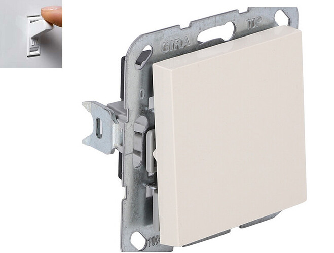

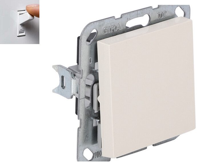

Actually, in the Netherlands, regular household buttons are toggle switches, not “momentary/push” switches.
(We use the right one in NL, but I added the left one for functional clarity.)
So, one press goes from the off state to the on state, and the next press does it the other way around. I want to trigger on any press, whether it’s from off to on or from on to off.
ah, thank you for the explanation. the switches than to have of that sort present themselves as switch entities, not binary_sensors. but regardless, that makes sense now.

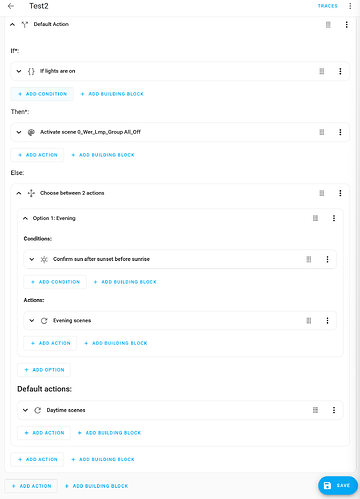

I simplified the trigger a bit for testing purposes, but I’m at this now:
alias: TestInoPlafond
description: ""
trigger:
  - platform: state
    entity_id:
      - input_boolean.ino_helper_bool
    from: "on"
    to: "off"
condition: null
action:
  - alias: Default Action
    if:
      - condition: template
        value_template: "{{ state_attr('light.0_wer_lmp_group', 'brightness') >1 }}"
    then:
      - service: scene.turn_on
        metadata: {}
          entity_id: scene.0_wer_lmp_group_0_all_off
    else:
      - repeat:
          for_each:
            - scene: scene.0_wer_lmp_group_1_all_on
            - scene: scene.0_wer_lmp_group_2_all_50
          sequence:
              metadata: {}
                entity_id: "{{ repeat.item.scene }}"
            - if:
                  value_template: "{{repeat.last == false}}"
              then:
                - wait_for_trigger:
                    - platform: state
                      entity_id:
                      from: "on"
                      to: "off"
                  timeout:
                    seconds: 5
                  continue_on_timeout: false
            - service: notify.persistent_notification
              metadata: {}
                message: "{{ repeat | tojson }}"
                title: "{{ repeat.last == true }}"
mode: single
this allows easy adding of multiple scenes

alias: Test2
description: ""
trigger:
  - platform: state
    entity_id:
    from:
      - "on"
      - "off"
    to:
      - "off"
      - "on"
condition: null
action:
    if:
    then:
        metadata: {}
    else:
      - choose:
          - conditions:
              - condition: sun
                after: sunset
                before: sunrise
            sequence:
              - repeat:
                alias: evening scenes
                  for_each:
                    - scene: scene.0_wer_lmp_group_3_evening_one
                    - scene: scene.0_wer_lmp_group_4_evening_two
                    - scene: scene.0_wer_lmp_group_5_evening_three
                    - scene: scene.0_wer_lmp_group_6_evening_four
                  sequence:
                      metadata: {}
                    - if:
                      then:
                        - wait_for_trigger:
                            - platform: state
                              entity_id:
                              from:
                                - "on"
                                - "off"
                              to:
                                - "off"
                                - "on"
                          timeout:
                            seconds: 5
        default:
          - repeat:
            alias: daytime scenes
              for_each:
              sequence:
                  metadata: {}
                - if:
                  then:
                    - wait_for_trigger:
                        - platform: state
                          entity_id:
                          from:
                            - "on"
                            - "off"
                          to:
                            - "off"
                            - "on"
                      timeout:
                        seconds: 5
mode: single
easily switch between the scenes i want to activate! with a simple choose condition i can have multiple scene options for evening, morning, during the day, when the wife is not home etc. etc.
it really requires the sequence to be put in a script to keep it manageable, but i will work on that!
it even looks okay on the gui editor :smiley:
ah… i had presumed (and i thought your original code also did) that if you waited more than 5 seconds then you are no longer cycling… but that the next press was considered the “first” and then follows this rule:
at what point does the press become “first” again? or is there really no such thing as “first” and you’re always doing the cycle?
