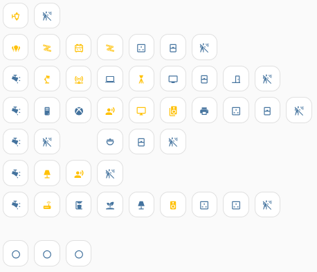

I have a horizontal stack card with multiple custom button cards. There is a condition in these cards that shows/hides the status. When the status is shown, the card becomes wider, and as a result, the mobile app has a horizontal scroll. Is there any way or card type where I can paste a set of custom button cards, and depending on their width, the line between them will break to avoid horizontal scrolling?

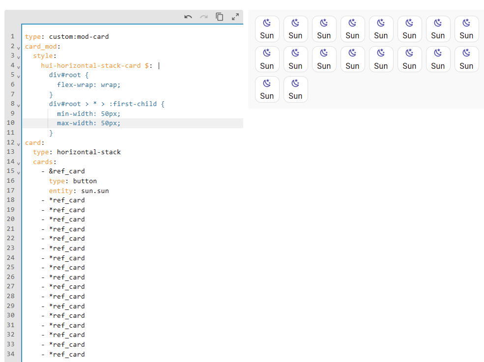

The only way is using card-mod to customize a behaviour of a flex container.
As a starting point:
type: custom:mod-card
card_mod:
  style:
    hui-horizontal-stack-card $: |
      div#root {
        flex-wrap: wrap;
        /* justify-content: ???? */
      div#root > * > :first-child {
        min-width: 50px;
        max-width: 50px;
card:
  type: horizontal-stack
  cards:
    - &ref_card
      type: button
      entity: sun.sun
    - *ref_card
    - *ref_card
    - *ref_card
    - *ref_card
    - *ref_card
    - *ref_card
    - *ref_card
    - *ref_card
    - *ref_card
    - *ref_card
    - *ref_card
    - *ref_card
    - *ref_card
    - *ref_card
    - *ref_card
    - *ref_card
    - *ref_card
ΠΈΠ·ΠΎΠ±Ρ€Π°ΠΆΠ΅Π½ΠΈΠ΅
And play with β€œjustify-content” property to get a more desired look.

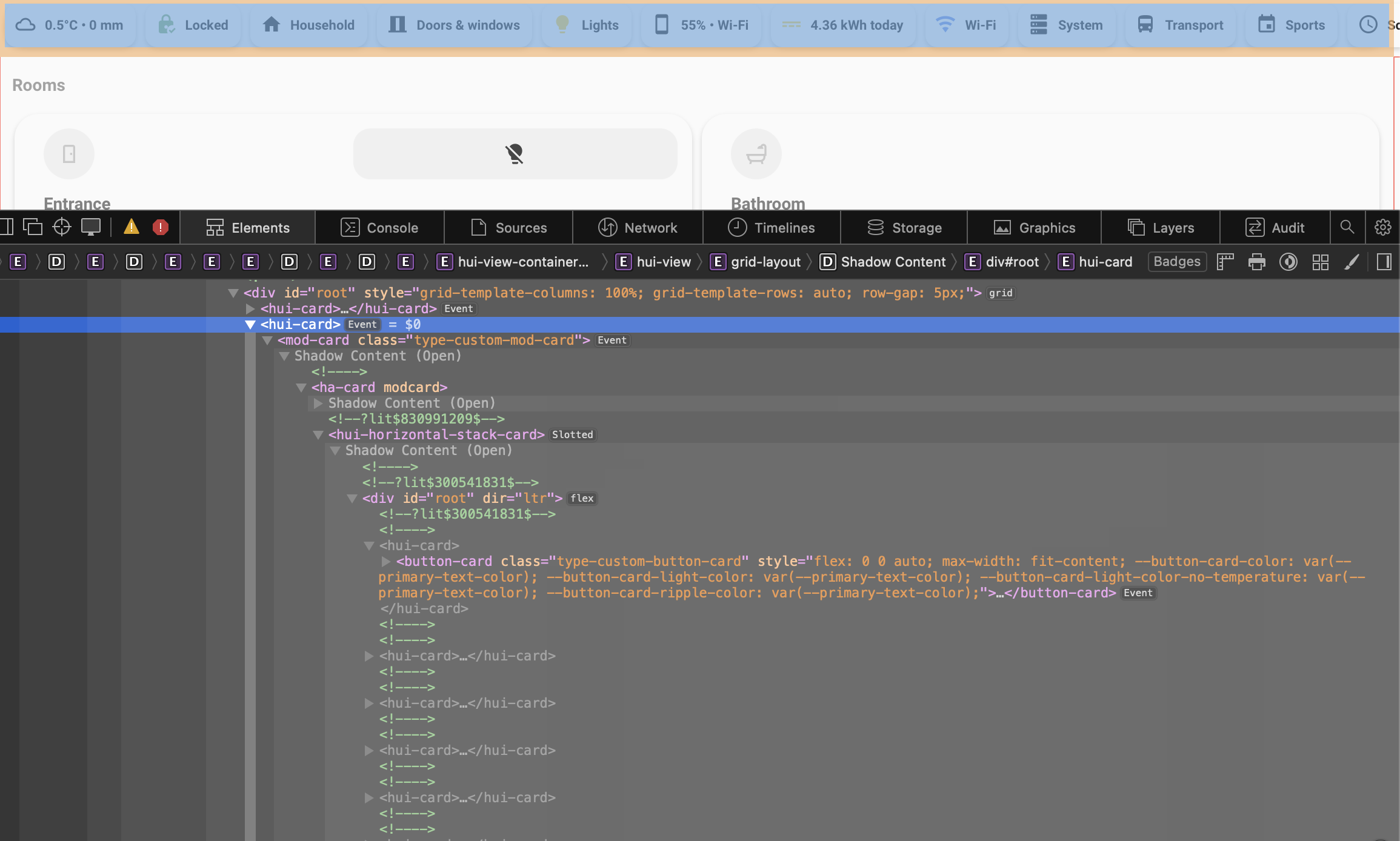

Up until now this has wrapped the elements, braking to a new row when reaching overflow-x. After updating, I have gotten a border shadow that I have not had before, and none of the card_mod styles seem to be applied anymore.
An inspect of my page if helpful:
According to an author of that v4 update , all old styles with mod-card should keep working.

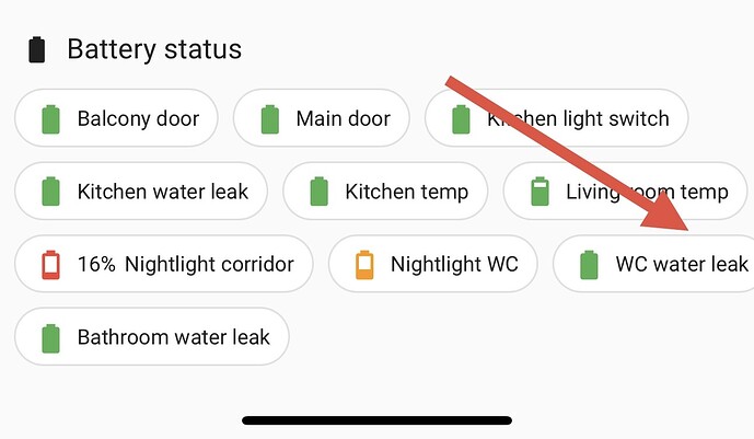

Also (might be useful), if you need to allocate buttons in a special way like this:
consider this simple way.
