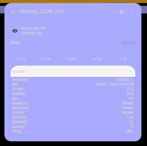

So I have made some progress, not sure I am going int he right direction. I read up on your two ideas for getting to use this as tracking data. Honestly, reading this stuff gets you shooting down rabbit holes and get lost in the confusion. However, I though I would post what I have changed so far and see if I am going in the right direction and what to do next with what I have for data at the moment.
So my Congiguration YAML now looks like this.
rest:
    resource: https://www.followmee.com/api/tracks.aspx?key=xxxxxxxxxx&username=xxxxxxx&output=json&function=currentfordevice&deviceid=12367877
      - name: "Richard_JSON_Info"
        unique_id: 2b97d
        value_template: "{{ value_json.Data[0].phoneinfo }}"
        json_attributes_path:  "$.Data[0]."
        json_attributes:
          - "DeviceName"
          - "DeviceId"
          - "Date"
          - "Latitude"
          - "Longitude"
          - "Type"
          - "Speed(mph)"
          - "Speed(km/h)"
          - "Direction"
          - "Altitude(ft)"
          - "Altitude(m)"
          - "Accuracy"
          - "Battery"
    scan_interval: 120
that produces an “Entities” entry when I look for it in entities.
Sorry for the CSS coloring…
Is this on the right track? Where would I go from here? Any pointers assitance is appreciated.

@tom_l
Yes you should be :see_no_evil:
Yes you have the information in Home Assistant.
Either of the two options I posted above. Neither are great. Known devices is old and not really wanted by the devs (though it does still work). MQTT is a lot of overhead. We really need a template device tracker (or restful device tracker).

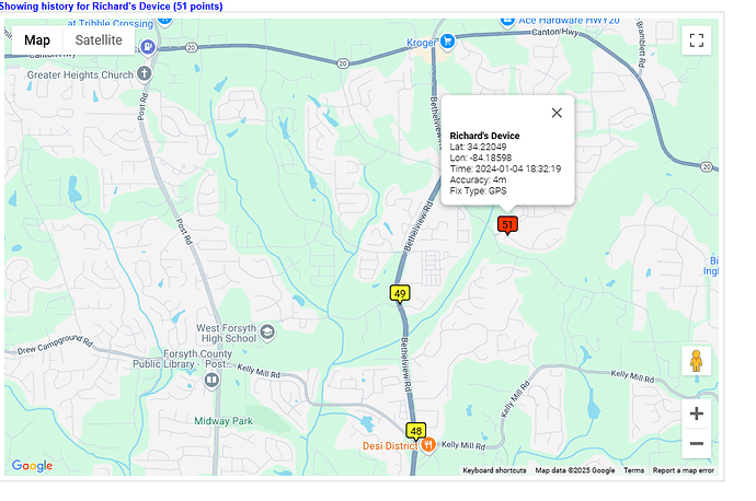

Now I have a question, maybe not the right place to ask… How to I stuff more information into the points that are ploted. Currently, it only shows "Richard’s Location and a Date & Time. How do I get the other stuff the rest api is pulling in? I have all the entities built, and they are recording it, just don’t know how to add their data to the clickable plot point. Is that possible?
Here is what I get now
In homeseer, below is what I was used to… What is really interesting in that plugin (PHlocation) he must be using the google API “Snap to Road” interpolation because all the points on my old system were always on a road.
This is the only integration that was way better in HS3/HS4.
