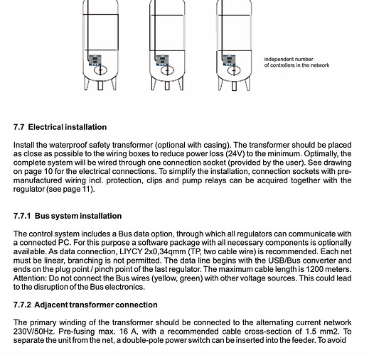

Ideally I want to be able to monitor the temperature of each tank via home assistant.
I don’t want to change the probes and temperature monitor/solenoids etc if possible. So if I can, I’d like to some how ‘hook into’ the current bus system?
Below is the details from the manuals of the monitoring system on the tanks, essentially they are daisy chained together, though this may just be for provision of power to operate them and work the solenoids.
Any ideas or tips would be gratefully received!

In the first picture there is a USB Bus converter mentioned. Maybe there is something printed on that device that can help you.
It’s definitely not KNX - characteristics don’t match (and it would be an awkward choice).
Modbus would have the same max. cable length.
Looking closer the bus is only two wires, green & yellow and terminated at the computer end by USB… Probably serial.
Edit: I agree serial modbus, over rs485.
