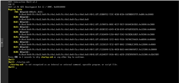

this was the last what I have seen after the failed update in the Proxmox VM shell before reboot:
Then I rebooted the VM (and later also Proxmox).
But the VM is still bricked:
UEFI Interactive Shell v2.2
EDK II
UEFI v2.70 (EFI Development Kit II / OUMF, 0x00010000)
Mapping table
      FS0: Alias(s) :HD0a0b:;BLK1
          PciRoot (0x0) /Pci (0x1E,0x0) /Pci (0x1,0x0) /Pci (0x5,0x0) /Scsi (0x0,0x0) /HD(1,GPT ,B3DD0952-733C-4C88-8CBA-CAB9B8B4377F ,0×800 ,0×10000)
      BLKO: Alias (s) :
          PciRoot (0x0) /Pci (0x1E,0x0) /Pci (0x1,0x0) /Pci (0x5,0x0) /Scsi (0×0,0×0)
      BLK2: Alias (s) :
          PciRoot (0x0) /Pci (0x1E,0x0) /Pci (0x1,0x0) /Pci (0x5,0x0) /Scsi (0x0,0x0) /HD (2,GPT,26700FC6-BOBC-4CCF-9837-EA1A4CBA3E65,0x10800,0xC000)
      BLK3: Alias (s) :
          PciRoot (0x0) /Pci (0x1E,0x0) /Pci (0x1,0×0) /Pci (0x5,0x0) /Scsi (0x0,0x0) /HD (3,GPT,8D3D53E3-6D49-4C38-8349-AFF6859E82FD,0x1C800,0x80000)
      BLK4: Alias (s) :
          PciRoot (0x0) /Pci (0x1E,0x0) /Pci (0x1,0x0) /Pci (0x5,0x0) /Scsi (0x0,0x0) /HD (4, GPT ,FC02A4F0-5350-406F-93A2-56CBED636B5F ,0×9C800, 0×C000)
      BLK5: Alias (s) :
          PciRoot (0x0) /Pci (0x1E,0x0) /Pci (0x1,0x0) /Pci (0x5,0x0) /Scsi (0x0,0x0) /HD (5,GPT,A3C664E-32CE-4665-95EA-7AE90CE9AA20,0xA8800,0×80000)
      BLK6: Alias (s) :
          PciRoot (0x0) /Pci (0x1E,0x0) /Pci (0x1,0x0) /Pci (0x5,0x0) /Scsi (0x0,0x0) /HD(6,GPT,33236519-7F32-4DFF-8002-3390B62C309D,0x128800 ,0×4000)
      BLK7: Alias (s) :
          PciRoot (0x0) /Pci (0x1E,0x0) /Pci (0x1,0x0) /Pci (0x5,0x0) /Scsi (0x0,0x0) /HD (7,GPT,F1326040-5236-40EB-B683-AAA100A9AFCF,0x12C800 ,0×30000)
      BLK8: Alias (s) :
          PciRoot (0x0) /Pci (0x1E,0x0) /Pc (0x1,0x0) /Pci (0x5,0x0) /Scsi (0x0,0x0) /HD (8,GPT,A52A4597-FA3A-4851-AEFD-2FBE9F849079,0x15C800,0x3EA37DF)
Press ESC in 1 seconds to skip startup.nsh or any other key to continue.
Shell>
Any idea how to fix this?

Shell> ha
'ha' is not recognized as an internal or external command, operable program, or script file.
Shell>
