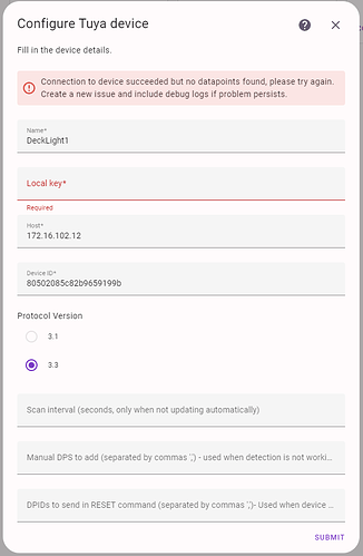

When attempting to add these devices in LocalTuya, I am receiving the following error (with the local key filled out obviously).
These devices work fine when connected via Tuya app.

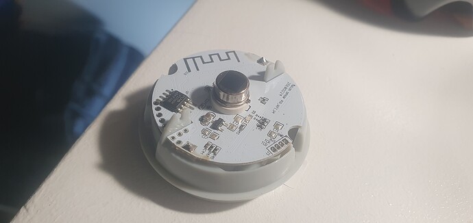

Is it possible to reverse engineer these, and flash them with ESPHome? I opened one device (the motion sensor) and noticed multiple pads that are available to solder to.

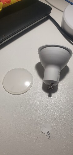

If they are not going to play well with Local Tuya, and just because I prefer ESPHome, it would be ideal if I could run ESPHome on them, the light bulb seems to be a little hard to get access to.

Your IP address seems to indicate a docker ip … just doublechecking as this should be the IP of the tuya device on your lan…
Note that it is also important that this does not change which I resolved by DHCP entry via MAC-address in my router
This motion sensor looks like being battery operated? In that case the esp is only powered when the primary (ultra low power) chip senses motion to send the changed binary sensor state over wifi. These devices are not officially supported by esphome but someone brewed something custom for that devices 3 years ago :point_down:
Indeed, like most of the β€œsmart” light bulbs. Best just buy them already freed with esphome, wled, tasmota, … flashed so you are not β€œforced” to break them to be able to own them :man_shrugging:
Looks like athom sells your (GU10?) type of :bulb:
Great, thank you! Some good info to go one here!
Since the gu10 is tuya and presumably using beken chips. You can still flash with libretuya, an esphome fork for non esp devices.
It’s also possible to flash it via ota method with tuya cloudcutter
