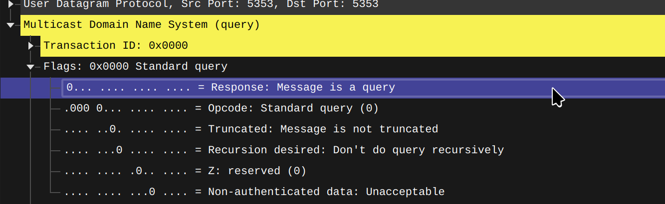

@ih,16,1 matches the message type bit in mDNS. 0 = query, 1 = response.
You can save this file as mdns.nft then load it with nft -f mdns.nft. Of course there are usually more idiomatic ways to do this in your router's distro.
