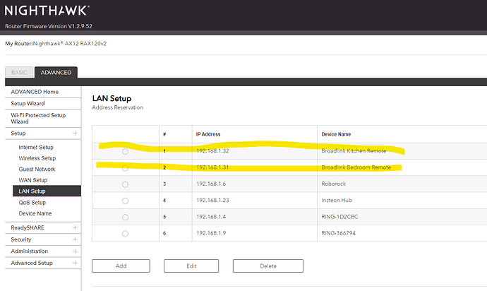

I have several Broadlink devices ant this problem is affecting them. After my router reboots, some of the Broadlink devices may be lost. They all have static IPs assigned in the router - but what I’ve found is that in HA’s core.config.entry file, the IPs may be wrong - i.e. don’t match the actual IPs. If I manually edit that file to contain the correct IP, and restart HA, the device is again available. So the device actually had the correct, static IP but somehow HA had a different IP for that device.
I’m looking for a way to avoid this chaos every time the router is rebooted. I see this bug was reported, but closed in GitHub with no action. Comments there claim the Broadlink integration uses MAC addressing and is not dependent on IP, but that’s obviously not the case.
