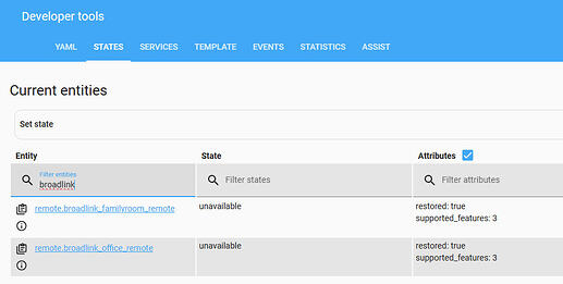

In the past few days my Broadlink RM3 Minis stopped working. Did I miss a breaking change?
Mini is still working with all the latest updates.
Check to see if you’ve got a new entity called broadlink.familyroom.remote_2
Good guess. I still don’t grok the _2 mess- I can’t think of a valid reason for them.
But, that’s not the issue here.

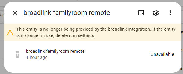

When both Broadlinks went “Unavailable” at the same time, I was looking for an issue that would affect both of them. Since everything else on my network was working fine, I skipped step 1: Reboot the device.
Working now.
It’s usually when the system thinks the ID exists and there’s no unique ID specified. The Amcrest integration often does this to me: If it times out on startup, it will create an _2 entity. Unfortunately, in such cases the integration devs need to fix it by providing a unique ID.
