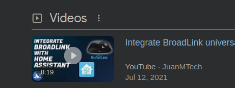

I’m trying to follow the JuanM video on setting up my unit. I’m running into a problem where I create a list of commands and try to teach them via my existing remote. When I run the service, instead of prompting
me for Volume Up then Volume Down, I get this prompt in notifications.
Learn command
Press the ‘Volume Up Volume Down’ button.
I ended up teaching a button at a time. I only needed two. Juan’s video informed me enough to get my automation running.
