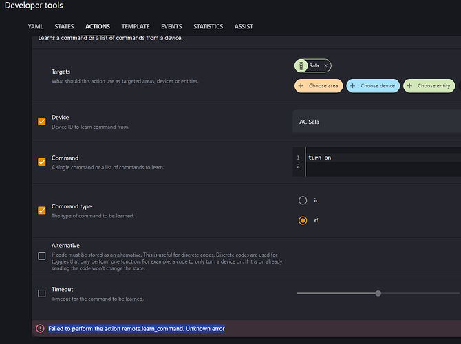

Thanks @scoutamis123. I was able to learn a new command in the Rm Mini, but every time I called the learn command in home assistant I’m getting the “Failed to perform the action remote.learn_command. Unknown error” :frowning: Any idea ?
The Log states “ValueError: remote.rm_mini doesn’t support learning RF commands”
I think the RM Mini only supports IR. The RM Pro supports both IR/RF, so if you’re trying to learn RF commands with the Mini that’s probably why it’s giving you that error.
