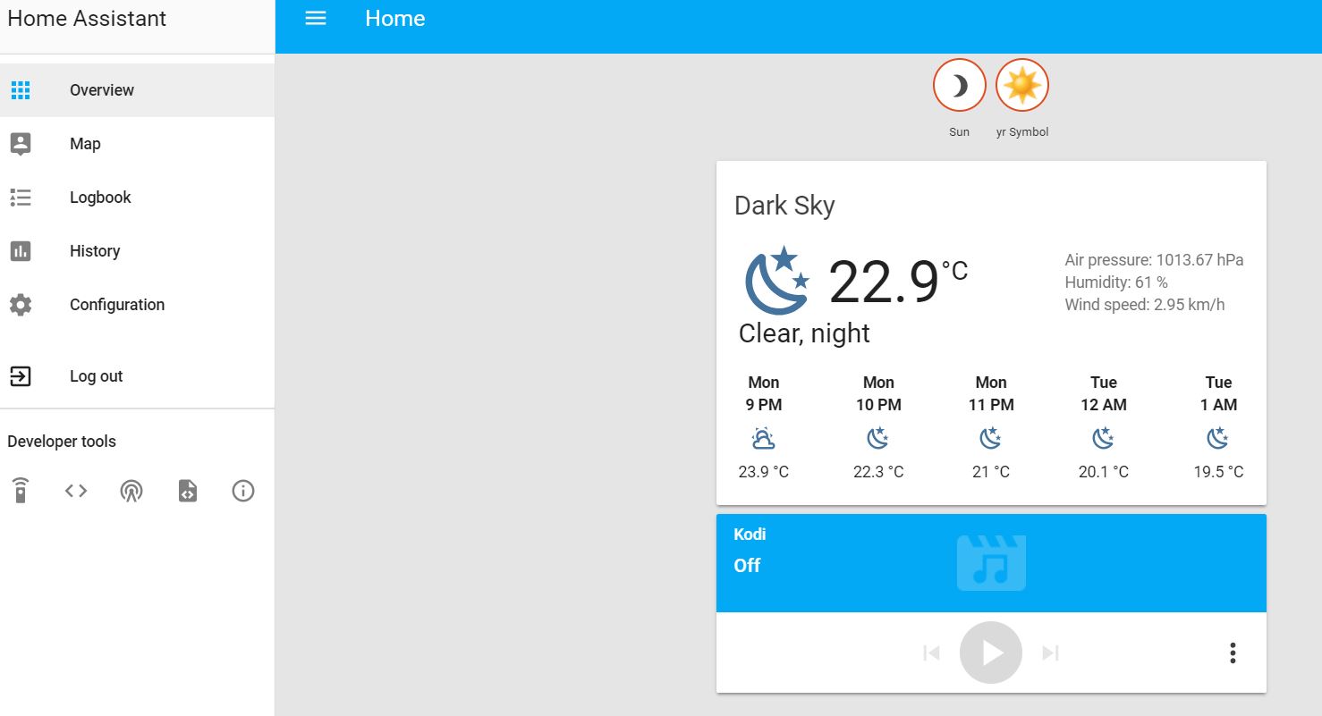

Thats what I get:

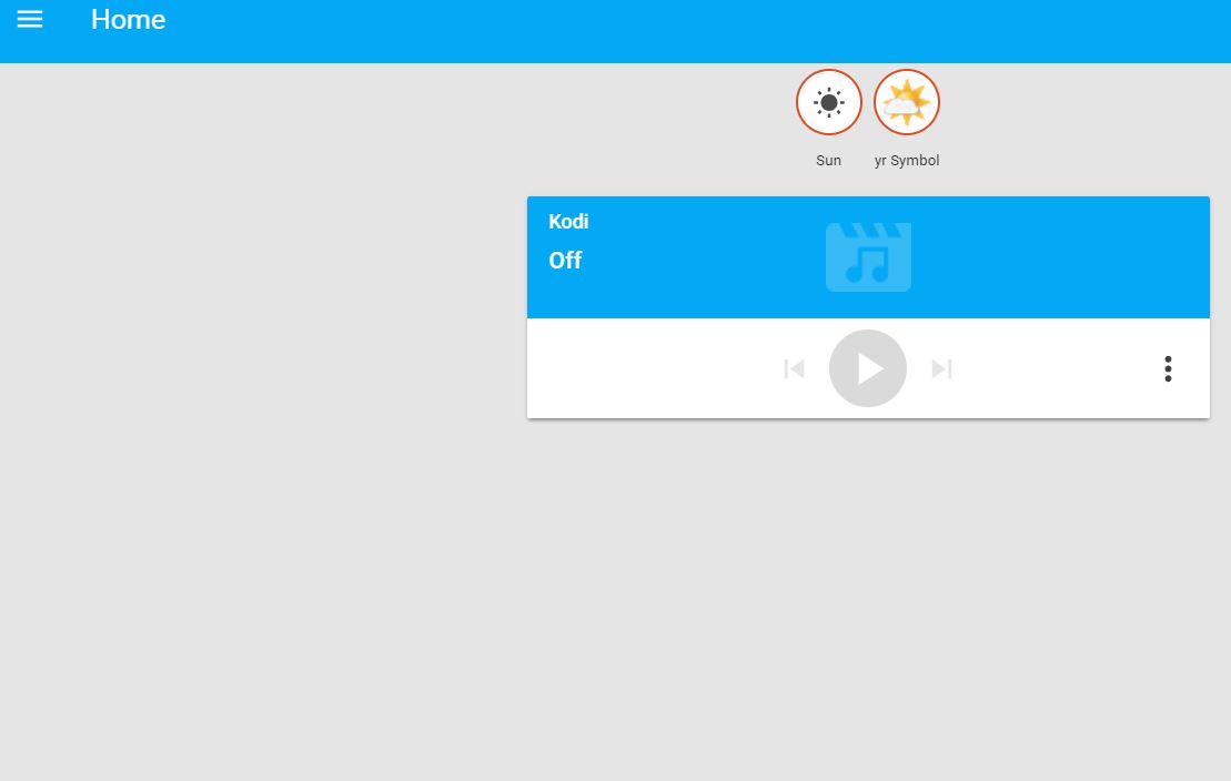

the thing is that all the devices controlled by broadlink disappear write after adding

Anyway, Switch box disappeares after restart and home-assistant.log shows mistakes:
