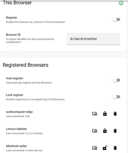

… and here is my browser_mod setup :
Lenovo-tablette is well still present :
So I really do not understand what causes the issue now since a few days … probably a recent update, but which one
