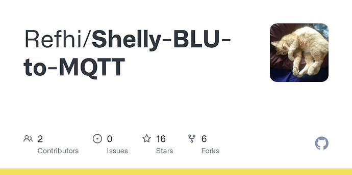

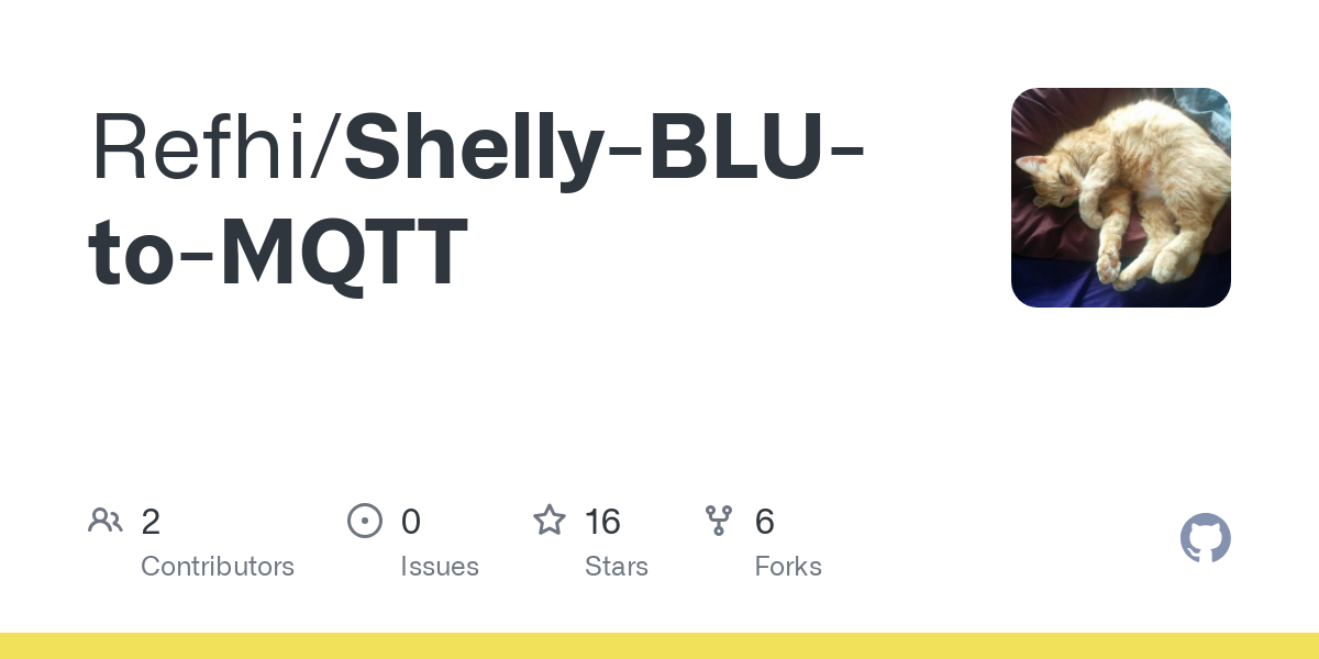

I’ve setup the MQTT broker, next setup MQTT in my bluetooth gateway (in my case a shelly plug s).
In that same shell plug s I’ve setup the script that is found here:
This ensured my blu door/window sensor data was send through MQTT to HA.
This was over a week ago and I haven’t missed a single opening or closing from the door. Yay! :smiley:

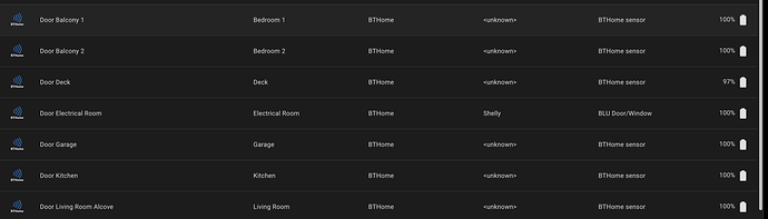

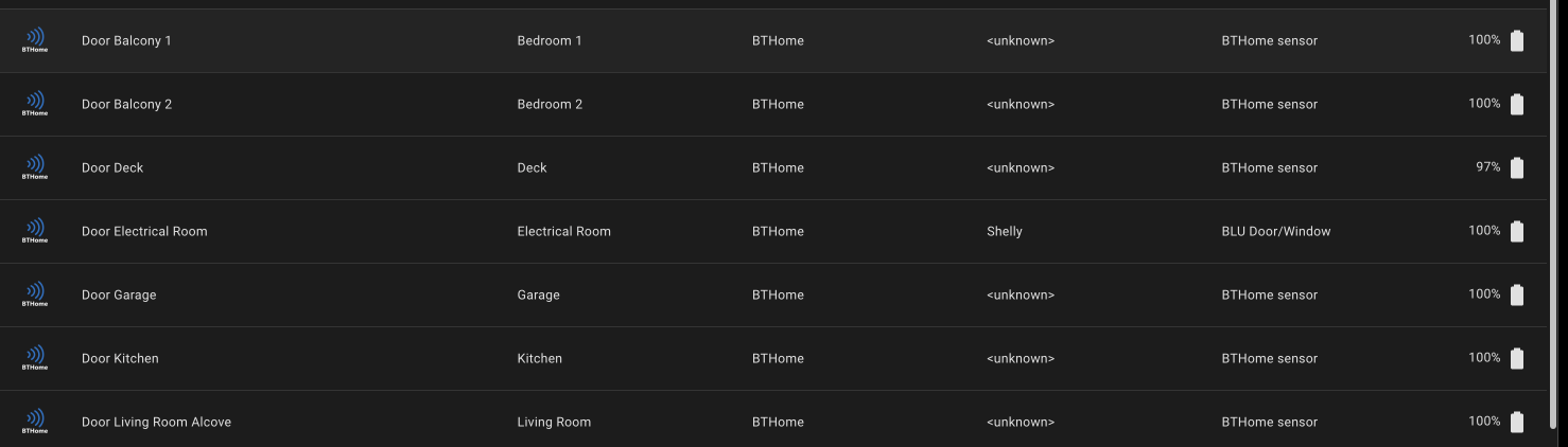

Me too. :frowning: But it’s highly selective, it’s only one single sensor for me, all of my sensors are on 1.0.23 and I’m using a bunch of 1PM Minis (not controlling any power, just acting as BLE receivers). 19 devices and all report properly, except one. I did notice one difference - it shows up in HA as a Shelly Blu sensor, wheras the others are “Unknown.” I didn’t add it specially or different than the others, but perhaps this is a clue?
In this capture, the one called “Door Electrical Room” is the problem, the others are fine. The one oddball sensor will report 100% fine with the Shelly app, but HA won’t see the change.
Also don’t know if it matters but the sensors occasionally, rarely, will “multi-report” - i.e. I open a door, I get open/close/open in rapid succession. But in these cases, HA does eventually “settle down” on the “correct” state so so far I’m not too worried.
