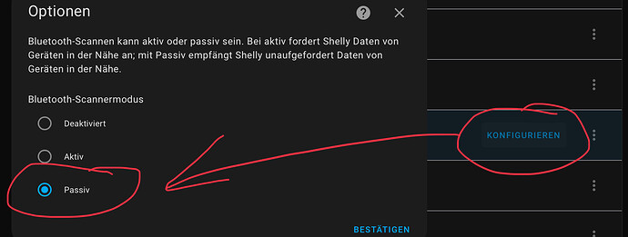

You Need to activate the BT in Homeassistant not in the Shelly App
Thats just what I did!
