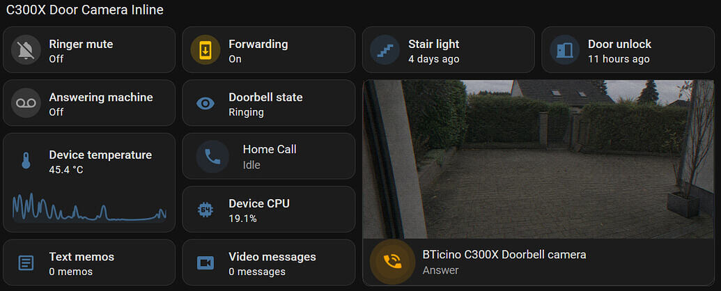

BTicino Door Entry for CLASSE300X13E
Just released v1.0.2(lovelace card & video firewall bugfix)....no more need for the app(but still supported)
Added
  • On-demand camera workflow for opening the doorstation from Home Assistant when nobody is ringing.
  • Real doorbell Ring Call workflow: answer and hang up the incoming C300X call from Home Assistant with video, device audio and microphone talkback.
  • Audio-only Home Call workflow from Home Assistant to the C300X.
  • Dedicated Home Assistant media-user handling. The agent prefers a
    homeassistant device user when present and falls back to an existing valid C300X user only when needed.
  • Bundled Lovelace card setup for the doorstation and Home Call workflows,
    including visual editor support and multi-device entity matching.
  • Android and iOS notification examples for door calls, dashboard open actions, Android high-priority/alarm-stream delivery and iOS critical alerts.
