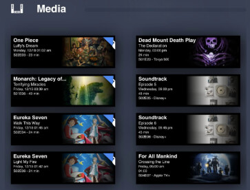

May I ask how did you create the media cards for the TV? Looks absolutely great!
That’s the upcoming media card.
Take a look at:
