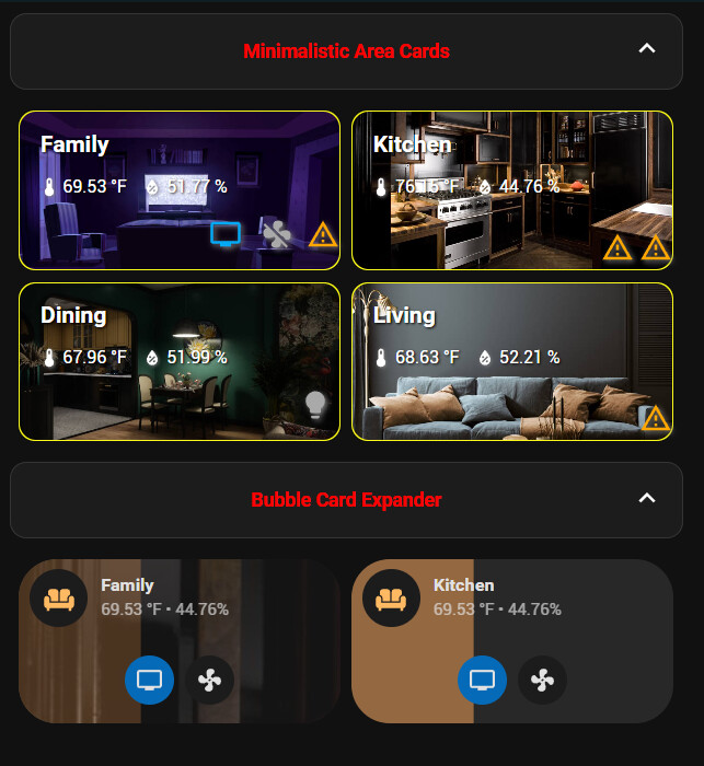

I am hoping someone can help me some css styling. I’m trying to mimic an existing minimalist-area card into a bubble card, and struggling to add a background image and borders. In the below here, you can see both cards being used, minimalistic cards above and bubble cards below. I was able to add a background image, but it doesn’t show correctly. And still working on getting the card sizing and border to match as well.
Can anyone help in figuring it out?
And below here is the current bubble code.
- type: custom:bubble-card
        card_type: button
        modules:
          - subbutton_below
          - get_state_attribute
        rows: "2"
        sub_button:
          - entity: media_player.family_room_tv
            icon: mdi:television
            tap_action:
              action: toggle
          - entity: fan.family_room_ceiling_fan
            tap_action:
              action: toggle
              perform_action: fan.set_preset_mode
                entity_id: fan.family_room_ceiling_fan
                preset_mode: Low
        entity: light.family_room_zone
        icon: mdi:sofa
        button_type: slider
        card_layout: large-sub-buttons-grid
        tap_action:
          action: navigate
          navigation_path: "#family"
        button_action: {}
        get_state_attribute:
          - entity: sensor.family_room_temperature
          - entity: sensor.kitchen_humidity
        show_attribute: true
        show_last_changed: false
        show_state: false
        styles: |-
          .bubble-button-background {
           background: url(/local/images/kitchen-dark.jpg);
           border-color: yellow;
           border-width: thin;
Bubble Card 3

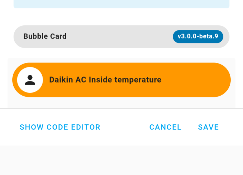

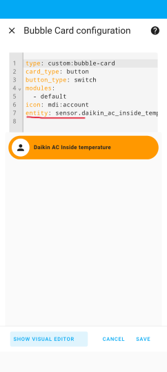

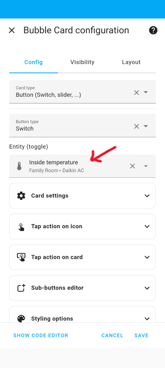

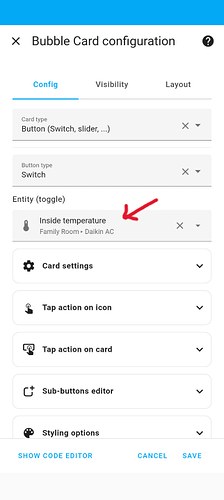

I’ve noticed a bug that has been happening for the last few beta updates across browsers and devices. When I try to enter/update the Entity_Id box in UI it just disappears. Though I can do that via YAML. As you can see from the screen shots.
Entity selection is available
The moment I try to enter anything, it disappears/gone, very annoying as I then have to YAML mode to edit.
I can see that still in YAML and edit, if I want to.
Has anyone facing the same issue. It the same behavior even with sub button entity Ids, and I thought either someone will raise it or will be fixed in subsequent releases. I did fresh install re-install but nothing works. Any help ?

Hi, can you check in the editor, at the bottom you will see the version, do you see v3.0.0-beta.9? I’m asking this because HACS is sometimes downloading the wrong version, and also because I already fixed this issue :slightly_smiling_face:
Yes, I’m on the latest one.
I just tried and I’m unable to reproduce this, could you open your browser console, then reproduce this again, then sen me the error you see in the console?
Check on Google if you never used the browser console :slightly_smiling_face:
Edit: This would be even better if you could open a new issue for that here.

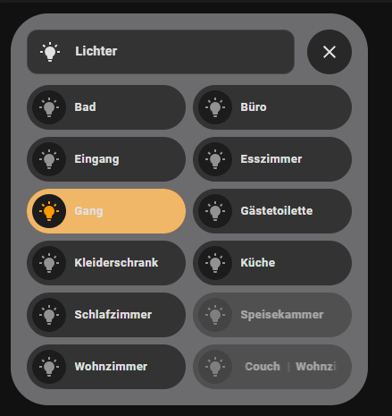

Can someone tell my why the “darkorange” background is a yellow?
The bubble Icon has the right darkorange
type: custom:auto-entities
card:
  square: false
  type: grid
  columns: 2
card_param: cards
filter:
  include:
    - options:
        card_type: button
        button_type: switch
        icon: mdi:lightbulb-on
        card_layout: normal
        modules:
          - home-assistant-default
        styles: |-
          ha-card {
            --bubble-button-main-background-color: ${state === 'on' ? 'darkorange' : '#333333'};
          .bubble-icon {
            color: ${state === 'on' ? 'darkorange' : ''} !important;
      domain: light
  exclude:
    - options: {}
      entity_id: light.lichter
show_empty: true
sort:
  method: friendly_name
  numeric: false
  reverse: false
  ignore_case: false
  ip: false
I don’t think it’s yellow but opacity. Adding 'opacity: 1 !important; below the line with “–bubble-button-main-background-color…” might work.
I ran the console and when click the entity box, the errors immediately started going up in endless loop but I see a repetition of the following ones.
strip_prefix_from_entity_name.ts:13 Uncaught (in promise) TypeError: e.toLowerCase is not a function
    at a (strip_prefix_from_entity_name.ts:13:43)
    at r (compute_entity_name.ts:55:12)
    at n (compute_entity_name.ts:23:10)
    at ha-entity-combo-box.ts:279:30
    at Array.map (<anonymous>)
    at L.<anonymous> (ha-entity-combo-box.ts:273:10)
    at L.willUpdate (ha-entity-combo-box.ts:387:26)
    at L.performUpdate (reactive-element.ts:1501:14)
    at L.scheduleUpdate (reactive-element.ts:1399:25)
2
reactive-element.ts:1369 Uncaught (in promise) TypeError: e.toLowerCase is not a function
Added more detailed version in here Entity ID disappears from the UI · Issue #1548 · Clooos/Bubble-Card · GitHub
Thanks for reply, but that does not work, no changes when i add it below :frowning:
Oke. What happens when you replace ‘darkorange’ in that line with ‘rgba(255, 140, 0, 1)’?
        styles: |-
          ha-card {
            --bubble-button-main-background-color: ${state === 'on' ? 'rgba(255, 140, 0, 1)' : '#333333'};
Same result :disappointed::see_no_evil:

Perhaps try adding:
background-color: ${state === ‘on’ ? ‘darkorange’ : ‘333333’} !important;
Not in the popup card but in the button card from your first post.
