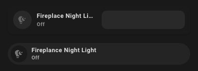

@Cloos Is there a function for bubble card to single or double tap to turn off a light or switch?.. instead of having to click the icon then select power, then click/toggle power? Just seems like a lot of clicking to turn something off.
Not the correct solution, but i bypassed this with the mushroom lightcard.
If you use the bubble theme it will look pretty decent.
guess that will work for now… was liking the round corners without having to modify css/card-mod
…also is nice to have the light name/description not get cut off from the mushroom slider bar
