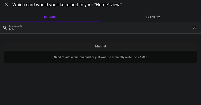

I went with the HACS install and everything seems to have gone okay. However, I’m not seeing the Bubble Cars show up on the Add Card dialog.
I did a full reboot of the HA (on VM) and cleared browser cache.
I tried adding the repository again and it says that it’s already in the store.

I wonder if that’s my issue from above? I’m not seeing the card from the dashboard’s edit page.
No it was not related to your issue. Have you correctly followed the installation instructions? You seems to be the first to have this issue.

I checked over several times and it seemed like I had. I didn’t put too much more effort into that since I’m using a temp VM and getting a Green. I figured I’d try again on that.
Solved. button_type: custom was missing.
