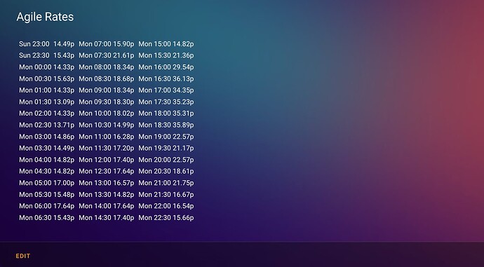

Thank you, that solved it. Do you know how to override the default theme of Bubble Card? I want to incorporate the custom Octopus Energy Rate Card But it’s coming out this like:
Where I want it to come out like the default of the octopus card (it’s colour coded based on price)
I don’t have Octopus Card to test but as far as I know Bubble Card does not add any theming to other cards.
Do you have a non-default theme for your entire Lovelace view?
Thank you again. I managed to resolve you, you need to add a horizontal stack first, then add the custom card within horizontal stack. Then the custom card’s theme will output correctly. If you try add the custom card before doing a horizontal stack, you get the bubble card theme issue as per my screenshot.

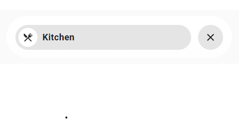

I would like to change the background colour of the icon that’s currently shown in white. I would also like to change the grey if possible?
type: vertical-stack
  - type: custom:bubble-pop-up
    hash: '#kitchen'
    icon: mdi:silverware-variant

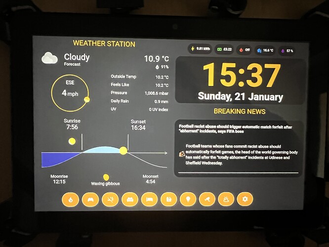

I have finally gotten to a stage where I have something half decent with my skills.
