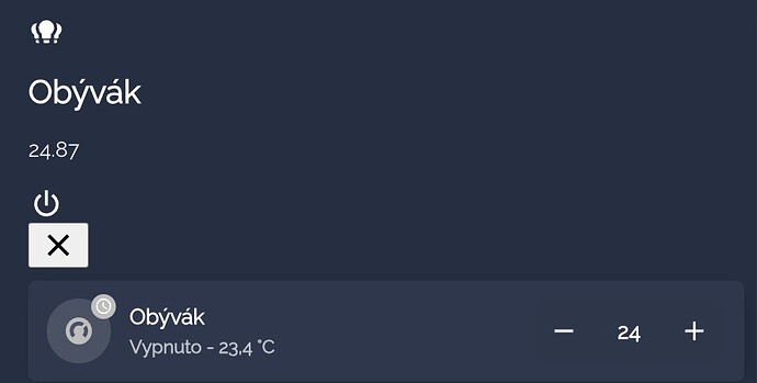

The card is only visible in the dashboard editing mode. How do I debug? Front-end cache is reset. Nothing in HA log.
edit: I am SOMETIMES able to see it in the non-edit default mode, but then I’m probably missing something. The entire thing is visible, the close button does nothing.
And at different times still, it falls apart like this (this is the Bubble card and only the Bubble card):

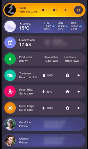

In the attached image (even from the cellphone it is the same), you can see the bottom I can’t go to what I built.
Plus - the names like Active and more. Like your pictures?
Here’s a picture
