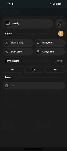

Home assistant lacks a simple, space efficient thermostat. A thermostat card in the bubble card style would be great. I don’t think it needs to be more than this functionality wise…
You have to tell me how to do that!
Indeed you are not the first to try that, I will indeed add some words about that!
And for your thermostat card you can now do it yourself easily with the sub-buttons, for example one for showing the temperature and two others for the - and +. I don’t have a smart thermostat myself so I don’t have any YAML example to show you.
