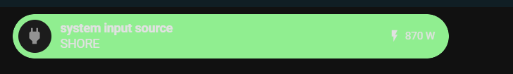

Hello Community i am new to this pop up bubble card and im trying things out… i made a button pop up with a PIN code display for door access security, but the pop seems to be too small to be readable in a wall tablet… how can i make this button pop up bigger? big enough so it can be read on a wall tablet.
or there other ways to display the PIN code bigger aside from a button.
Insert the following code in the custom styles section:
font-size: 16px !important;
Maybe even better is the following example:
type: custom: bubble-card
card_type: button
card_layout: large
styles: |
.large .bubble-button-card-container {
height: 120px;
.bubble-name-container {
height: 40px;
font-size: 35px !important;
button_type: switch
rows: auto
entity: “your.entity”
i already tried this code but the text become crop inside the button card.
If you use the exact code as posted above (the example I posted) it should look like this:
Of course depending on what entity and text you choose…

Thanks its bigger now just like on your picture… can i make the icon bigger too? I used the code on github to make icon larger but its not affecting anything…
styles: |
.bubble-icon {
--mdc-icon-size: 26px !important;
Hi the following code-snippet should work:
.large .bubble-icon-container {
--mdc-icon-size: 36px;
min-width: 58px !important;
min-height: 58px !important;
margin-left: 8px;
