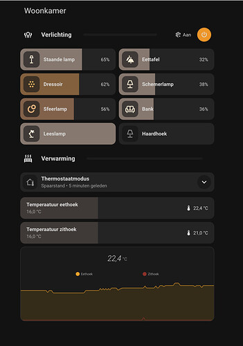

Bubble cards are amazing. I used it to set up something like this:
Note the radius that I managed to set to 12 of most elements with this css codes:
            styles: >-
              .bubble-button-card-container, .bubble-button-background,
              .bubble-range-slider {border-radius:12px !important; }
              .buble-sub-button, .bubble-icon-container {border-radius:11px
              !important;}
(slider)
            styles: >-
              {border-radius:12px !important;} .buble-sub-button,
              .bubble-icon-container {border-radius:11px !important;}
              .bubble-button-background { background-color: ${state === 'on' ?
              '#948278' : 'var(--bubble-button-background-color) !important'}; }
              .bubble-icon-container { background-color: ${state === 'on' ?
              '#49423e' : 'var(--card-background-color,
              var(--ha-card-background)) !important'}; } .bubble-icon { color:
              green; } .bubble-icon { color: ${state === 'on' ?
              'rgb(255,220,200)' : 'var(--card-icon-color)'}!important; }
(switch)
            styles: >
              .bubble-range-slider {border-radius:12px !important;}
              .buble-sub-button, {border-radius:11px !important;}
              .bubble-button-background {background-color:
              var(--ha-background-color);} .bubble-range-fill
              {background-color:#49423e !important;}
(Input number)
However, I get stuck with the input select. This is what I tried now:
.bubble-select-card-container, .bubble-icon-container {border-radius:12px; !important}
.mdc-deprecated-list, .mdc-menu, .mdc-menu-surface {border-radius:10px; !important}
.mwc-list-item {border-radius:12px; !important}
mwc-list { background-color:gray !important;}
Resulting in this:
afbeelding
Anyone an idea how to change the radius and background color of the drop down menu and menu selector?
