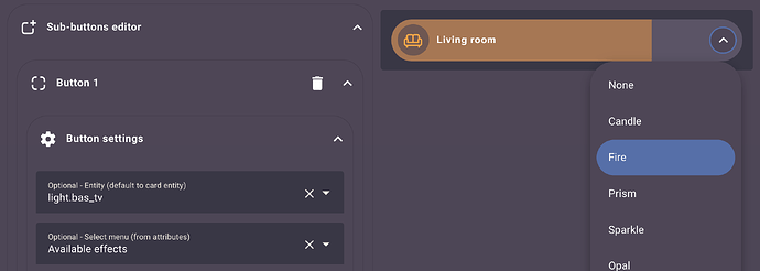

Select cards and sub-buttons now support attribute lists
Select cards and sub-buttons now support attribute lists for climate, light, and media player entities. This option will only show if your entity is supported. #665
