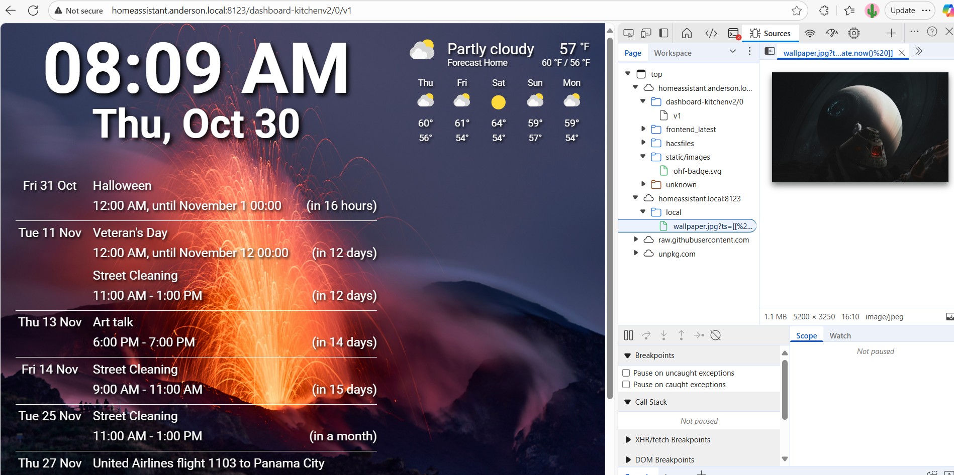

I changed the URL to: http://homeassistant.local:8123/local/wallpaper.jpg
But as you can see, its still caching wonky… I need a way to append a random string at the end of the URL to force the brower to not have it in cache:
Control+R in Chrome does not update the image.
