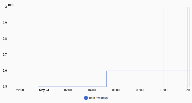

Hmmm… I have to come back on this, because it isn’t functioning like I expected.
This statistics sensor works perfectly with my Netatmo rain sensor, but apparently the Buienradar 24h sensor behaves differently.
The Netatmo sensor counts the total precipitation for the current day, and this value is reset at 00:00 every day:
The statistics sensor handles that correctly, showing the total amount of precipitation for the last five days:
However, the Buienradar sensor gives the total amount of precipitation for each last 24 hours:
And the statistics sensor also counts the values when the amount goes down:
I did expect that only the values going up would be counted (nonnegative), but apparently it doesn’t work like that.

As a test I created a statistical sensor from the Buienradar 1d sensor, using the sum_differences_nonnegative characteristic for the statistical sensor:
sensor:
  - platform: statistics
    name: "Rain 1d five days"
    unique_id: uid_rain_1d_five_days
    entity_id: sensor.rain_1d
    state_characteristic: sum_differences_nonnegative
    max_age:
      days: 5
This is the output from the Buienradar 1d sensor and the statistics sensor for the last two weeks:
It is shown that the Buienradar 1d sensor is not reset to zero every day, and the resulting statistics sensor does not give the correct output.
Like I wrote before, it of course is better to use real measured values, so I am now using the values from my own Netatmo Rain Today sensor to do the same.
This sensor indeed is reset to zero every night at 00:00
This is the result of the Netatmo Rain Today sensor and the statistical sensor for the last two weeks:
This statistical sensor indeed gives exactly the correct amount of rain that was fallen in the last five days.
So to correctly use this statistical sensor you indeed need a sensor that only is increasing during the day, and that is reset to zero at the end of each day.
