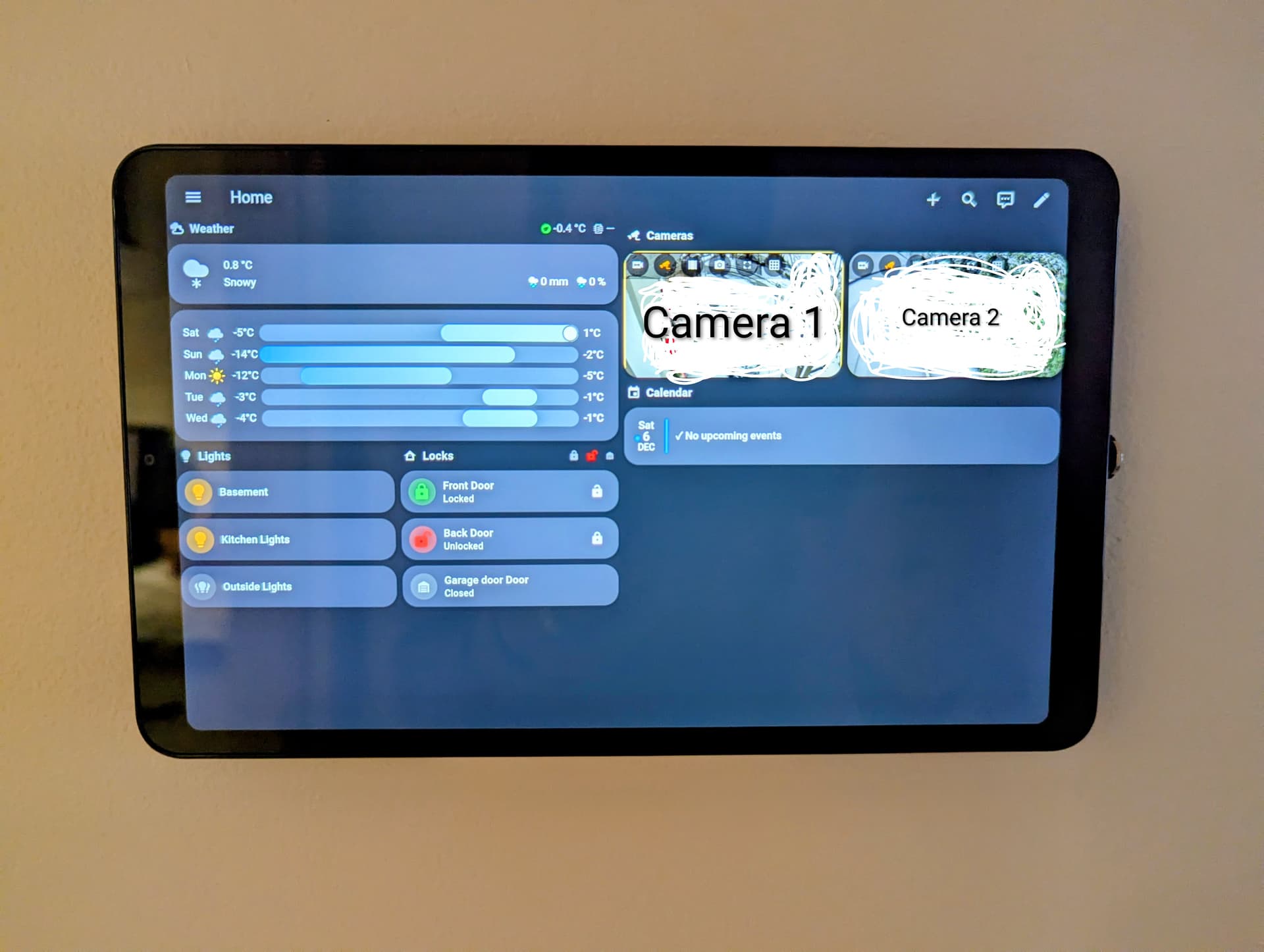

This is photos of what I was able to get so far in my trial run. Sorry for the lack of photos, but the place is a mess from packing and i figured ill take a lot more when i do the final install in the new place with the amazon tablets (update incoming).
Parts List
As an update I realized I forgot to mention I had expanded this to use a 2nd dashboard running on a Samsung Galaxy A Series entry level tablet I got for free from my cell carrier. Its not the most powerful but its performance is good enough for a few camera feeds on the dashboard and its got built in battery conditioning and charging limits
