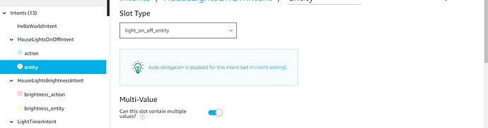

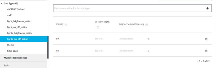

My settings for “HouseLightsOnOffIntent”:
