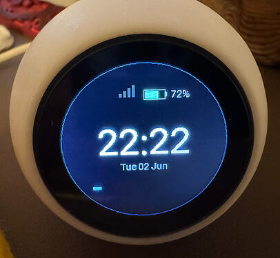

(Photo of the ball :backhand_index_pointing_down:)
