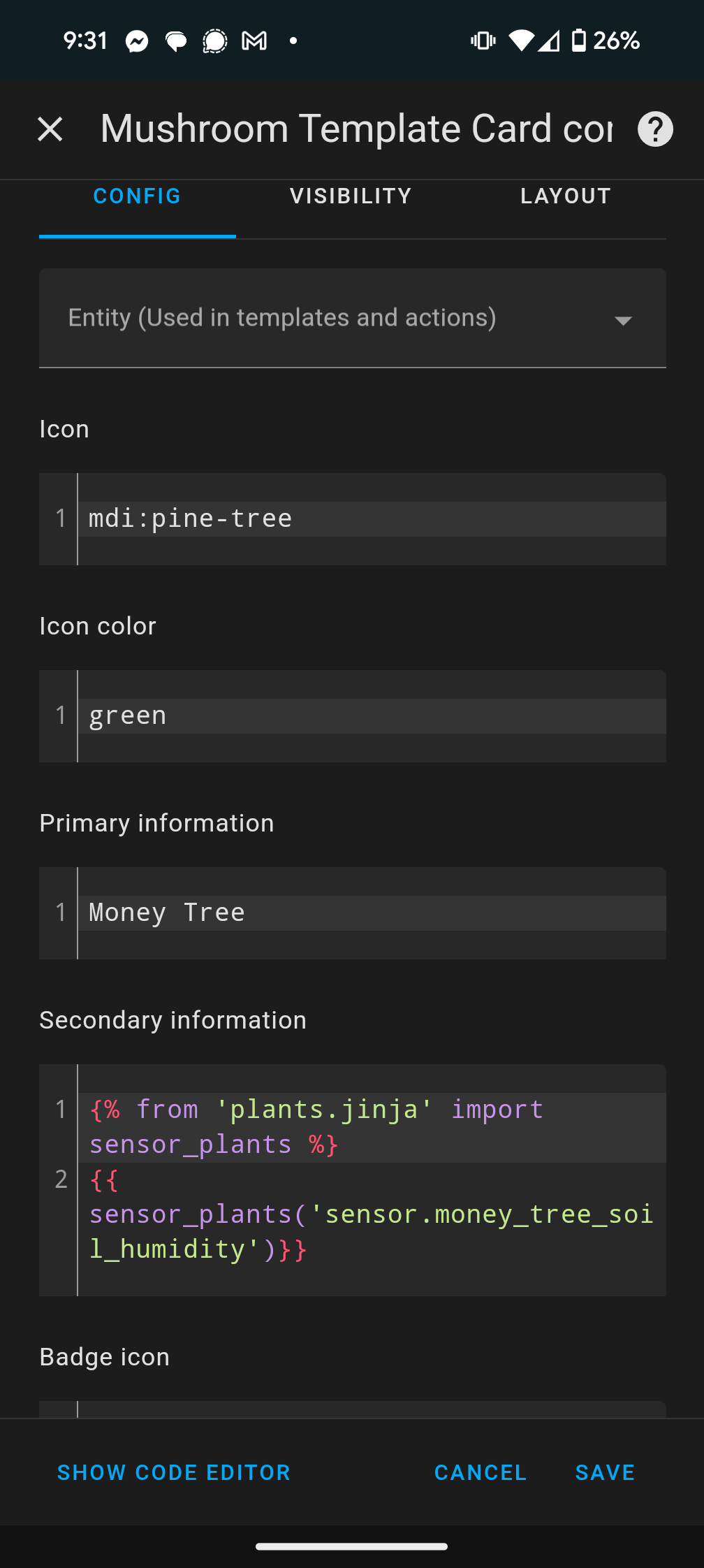

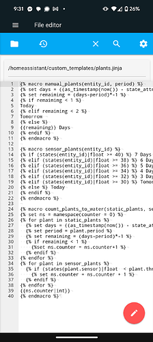

I ran into the same issue. As of HA 2023.4, macros work nicely to reduce code duplication in templates, be it with some minor drawbacks at the moment.

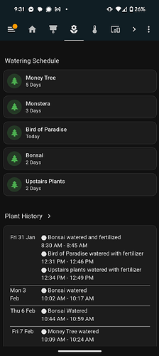

Thanks for this! This was exactly what I was looking for. I was able to create a macro with functions that determine the amount of days remaining until my plants need water by passing the last watered date for each plant as a variable. Then I call the function in a template card on my dashboard.
