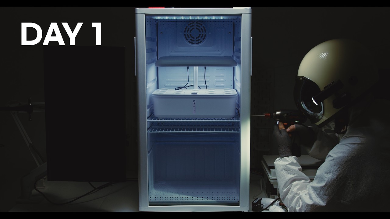

Phase 1: Converted refrigerator → Smart plant growing chamber (ESPHome + relay control)

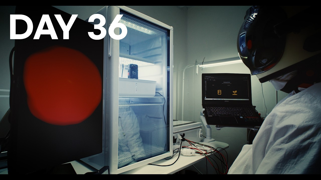

Phase 2: Home Assistant API → TouchDesigner real-time integration success! Implemented visualization where sensor data transforms into colors and shapes
